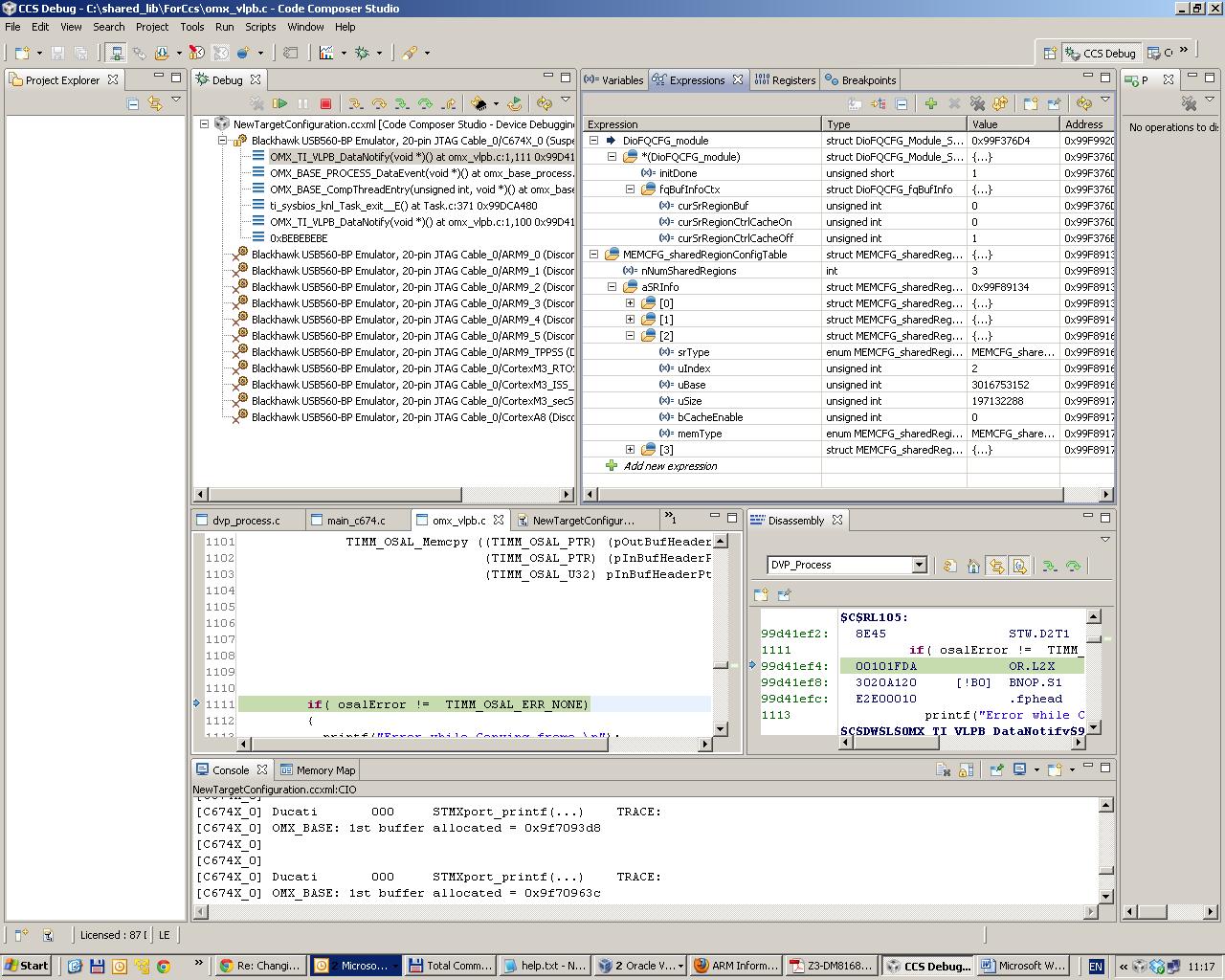

    We are currently looking with the CCS on the DSP, the variable DioFQCFG_module->fqBufInfoCtx.curSrRegionBuf is 0
    and the variable MEMCFG_sharedRegionConfigTable.aSRInfo[2].uIndex is 2.

  • Can you show a screen shot of the field values in DioFQCFG_module? And can you confirm that you have modified :
    #define OMXBASE_DIOFQCFG_MODSTAT_CURSRREGIONBUF           (2)  <Tells the DSP which shared region to allocate Buffers from>
    in <OMX_ROOT>/packages/ti/omx/demos/dm81xx/src/app_cfg.h, rebuilt the omx dsp binary and are loading that on the dsp ?

  • Hi Archith,
    We have verified that
    After this in EZSDK root directory we ran <make clean> verified that all executables were deleted and then ran <make all> and moved the new executables craeted to the NFS .
    After this we open the CCS with the c6xtest (vplb) example.
    The variable DioFQCFG_module->fqBufInfoCtx.curSrRegionBuf remained 0 as can be seen in print screen below.
    Maybe this variable DioFQCFG_module->fqBufInfoCtx.curSrRegionBuf receives a hard wired value somewhere in the code.
  • To debug this, we need to see what is the value at load time. For this, modify the main function like this:
    main ()
      volatile int i =1;
      while (i);
    In boot up time, when DSP core gets loaded, the DSP will be brought out of reset , xdc runtime init scripts will run and main will be entered. So at this stage, you can connect to the DSP and see that the DSP is looping inside the above while (). In the expressions window, set the value of i to 0 and break out of the loop and see the value of
    DioFQCFG_module->fqBufInfoCtx.curSrRegionBuf  (take care that you have put a BKpoint after the while statement). If its 2, then your hypothesis looks probable.. To catch where this is getting changed, you can put a HW watch point (configured to catch writes) at the addess of this variable and the emulator will halt at the moment of write. If we know where it gets changed, we can track down what config got missed.

  • Hi Archith,
    We put in main
      volatile int i =1;
      while (i);
    and we see that DioFQCFG_module->fqBufInfoCtx.curSrRegionBuf is 0.
    Where can we see this variable set in source code?
    If i change it in the main by myself should it work?
    Gabi
  • Hi Archith,
    We changed the variable DioFQCFG_module->fqBufInfoCtx.curSrRegionBuf  to 2 manualy in the CCS and ran the VLPB with allocation of big buffers and allocation was successful, this gives us the idea to set DioFQCFG_module->fqBufInfoCtx.curSrRegionBuf  to 2 in the main function.

  • I think the problem is that the file where we set the variable value OMXBASE_DIOFQCFG_MODSTAT_CURSRREGIONBUF in the struct  DioFQCFG is present in an object file omxbase_cfg.oe674 which is not and cannot be built in the EZSDK as available on the web. I guess thats why changing the macro value didnt work for you.
    I am attaching a copy of the library from my machine which has the changes require. Can you please put it in the lcoation <OMX_ROOT>/packages/ti/omx/comp/omxbase/lib/c6xdsp/debug and look at whether the mem allocation works?

  • Hi Archith,
    Thank you very much for your help, it is working OK now.
