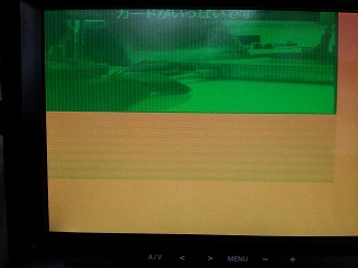

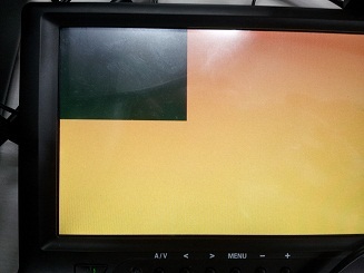

I have a question about v4l2 capture drvier. I try to work tvp5147 on videoin1 , but not work.
Questions
1. Video standard of tvp5147 support NTSC/PAL. 1080P,1080I and 720P is not support.
The capture driver support NTSC/PAL input ?
2. Tvp7002 was work on videoin0. Video output format is 20-bit 4:2:2 outputs with Embedded Syncs.
Did the capture drvier support Separate Syncs ( Embedded Sync disabled ) ?
Beause if tvp5147 is not work, I try to work SiI1161 device.
