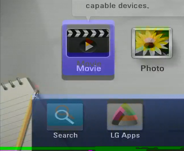

We managed to get the EVM to capture data from the component input at 720p... but...
the video is not "aligned".. the luma and chroma are offset. There is also a bar of "junk" a the bottom of the screen. I imagine the 2 issues are related, but...
The full h264 file is at http://syr.criticallink.com/files/sample.h264

Is this operator error or something else???
thanks

  • Hi Tim,
    At our end we tried the same but not seen any artifacts and it is working fine.
    EZSDK version used: 5.04.00.11on DM8148 EVM.
    Please give some more information about your setup and version of EZSDK.
    Vijayvithal Onkar
