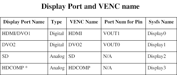

  • TI81XX_VPSS_Video_Driver_User_Guide.pdf, page 10
    Is DVO2 mapped to "/dev/video1"?
    Is HDMI/DVO1 mapped to "/dev/video2"?
    SD and HDCOMP are mapped to "/dev/video3"?
    All displays are independent of video nodes. Any of the video nodes that is /dev/video1 and /dev/video2 can be connected to any of the displays. /dev/video2 can be connected only to SD display.
