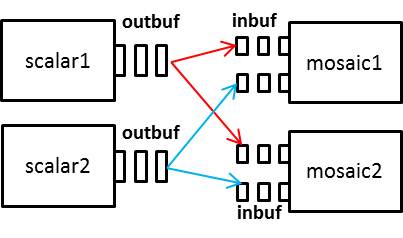

        I want to multiplexed use the decoded data stream between several swmosaic components. Now I use memcpy to copy the output data of the decode component to each input port buffer of the swmosaic components. But the arm in the DM8168 could not manage to do this job quickly enough, and the output video has big time-delay and the stream even interupt. I wonder if I can just offer the buffer header instead of doing data copy. But I don't know how to realize this. So, could you give me some help?
  • Hi Pavel,
        I found that Archith gave a post at http://e2e.ti.com/support/dsp/davinci_digital_media_processors/f/717/t/140890.aspx. He said that the display components could share the same output data of one scalar component  using the OMX_UseBuffer calls to use the outbuffers already allocted by the scalar component as their inbuffers. I don't know if I can use this to solve my problem. Could you give some advice on how to realize this?

  • Hi Pavel,
        Thanks for your reply! My work is based on the Decode_MosaicDisplay example. I add the UDP receive and send parts, NoiseFilter components, encode components to the example. The following picture shows what I want to do. I want to reuse the output data of scalar components without copy. So, could you give some advice? Maybe you could help me to pass this issue to  Archith.
       Thanks so much!
  • Hi Pavel,
