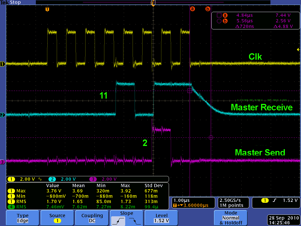

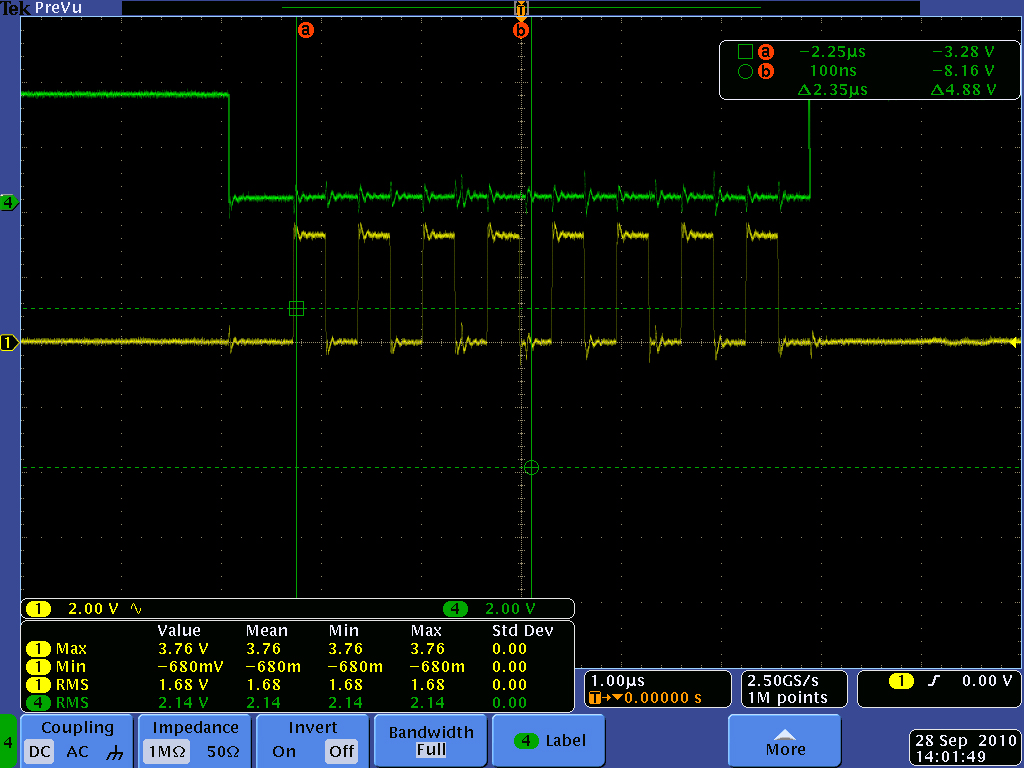

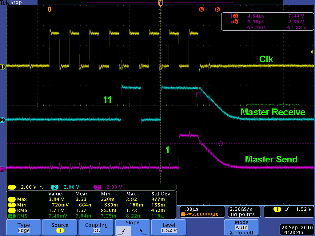

    The diagrams are attached.
    1. Clk and Chip Select
    2. Master-Slave 11 and 1
    3.Master-Slave 11 and 2
    When 1 and 2 is send from the master it receives 11 from the slave.
    Lijesh
  • Hi Lijesh,
    It looks like to me the slave sends the first data out twice from start. Could it be the writting to the slave DXR is too late for some reason? How fast do the master and slave run? How fast is CLKX? Maybe you need to check at the master/slave synchronization.
    Thanks.
    I am using same program on the master and slave side.Only difference is master init and slave init configurations.
    Sample rate generator divider value is 31. SPI clock is 1.5MHz.
    The slave side must be the problem. I am able to read EEPROM using the same program, where 6437 is master.
    Lijesh
    I agree with you that the slave must be the problem. It should not send the first data out twice. The only thing that I can think of is the slave writes the first data (11) into the DRR and then when the clock and frame come from the master, the slave sends the data (11) out. While it sends out the data (11), it has not written data (12) into the DRR, but the frame and clock come again so it sends out the data (11) in the DRR again.
    But then I cannot explain how the slave catches up with master after the second transfer.
    Maybe you are already doing this but I did not see if you had configured the slave transmit clock pin is from external clock.
    Thanks.
    -Tai

    All the 10 transfers happen equally timewise. The next iteration the master sends 1 and receives 20 from the slave.
    i.e. Master first receives 11,11,12...  19 (10 bytes).  So 20 pops out for the next iteration.
    Also tried without printf. But no difference.
    Another interesting thing is if i call SPI_Slave_Init ( SPI_8BIT ) before sending each byte on salve side, I am able to receive data correctly.!!
    unsigned char ReadBytes ( char * buffer, unsigned long Bytes )
        unsigned long Data;
        int i=0;
        for(i=0; i<Bytes; i++)
    SPI_Slave_Init ( SPI_8BIT ); // This step on slave side solves the issue.
        //Read one byte of data
        Data = SPISendReceive ( buffer[i] );
        printf("Byte Send: %d \n", buffer[i]);
        printf("Byte Receive: %d \n", Data);
    //    return ( Data );
    Actually I dont need to do the complete initialization. These steps are enough.

    This is not the proper way. It will reduce the through put a lot.
  • Lijesh,
    You get the same data twice in the case of an underflow.  There are a couple ways to overcome the problem.  Basically you need to do TWO writes to DXR at the start of your transfer.  You could do that by choosing either one of these options:
    1. Switch to interrupts.  You will get an XRDY interrupt as soon as you take McBSP out of reset.  After your ISR writes to DXR that data will be immediately shifted into XSR and will generate a 2nd interrupt before you've actually transmitted/received any data. - OR -
    2. Write some additional functions like SpiSendReceiveFirst and SpiSendReceiveLast.  These are the 'special cases'.  For "First" you would do only a write (no read).  For "Last" you would do only a read.
    Brad
