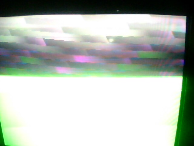

I'm using raw capture example to acquire images from a cmos sensor as some of us suggested. Now I can download the image, but color are incorrect, I have changed sensor settings like shutter row number, Green, Red and Blue Gain, but without results. I set sensor in YUV mode and this the result:
When I put U=V=128 I suppose that the image results in gray scale but it is all black!
What I do wrong? I also notice Vertical row in my image?!
  • I am glad to hear you now get an image from your sensor, I am sure this is something that can be cleaned up in software. Looking at the image initially it looks to me like you are missing the blue channel of a RGB image, but you mention that your sensor can output YUV so I am not sure this makes sense, perhaps it could be a configuration problem on the sensor?
    Is there a public place on the web where the datasheet for your sensor is posted? I am curious about the data formats it is capible of outputting and how much configurability it has, this is probably either a format disagreement somewhere or a bad color space conversion configuration in the sensor.
    I suspect the vertical lines are just another byproduct of the issue that is causing the color problem, if there is a format disagreement it could manifest itself in vertical lines if one side is expecting more bits (per pixel) than the other.
  • Yes,it partially works..... thank you so much for the answers! The sensor is Micron MT9D131, there is limited documentation at Aptina site! It can output:
     RAW Data : 8+2 bit, YUV and RGB (in various format 565 etc..). I set YUV output and I can see that the amount of byte is exactly 480x720x2,(ie: Y0 U0 Y1 V0) and if I change in CCStudio Image Tool one of channels I see one image with 2 sort of small transparent image on it (It seems the typical effect of turning channels in YUV format). I will check if there is Blue Gain disable or something similar? In CDDC configuration I leave :

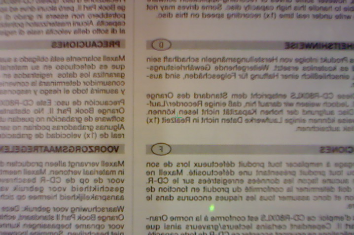

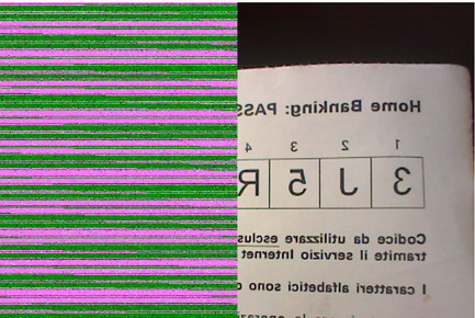

  • Another step is on!
    Now I have this problem, I set correctly the frame size in sensor register, but I don't solve the problem! Curiosly the size of noise sector is 360 = 720/2;
  • I am glad to hear that your situation has improved, I am curious what you had to change to get this output image?
    That green and pink noise is what uninitialized memory looks like when you try to display it as a YCbCr 4:2:2 image, at least I have seen similar noise when displaying frame buffers that were never filled. This being said the right half of your image looks great, I assume that there is no scaling going on here based on the text in the proper part of the image, i.e. the right half of the image is really just the right half of the image and not the whole thing scaled to the right half? Is it correct that the text should be horizontally reversed like that, as if your camera is looking at the text in a mirror?
    To debug this my suggestion would be to modify the timing registers to adjust when the frame is captured, in particular the SPH (start pixel horizontal) field to see if you can shift the image, depending on how it reacts you should be able to determine better where the problem lies if not fix it with the change.
  • Finally I found a solution! I put this strange setting  WIDTH = 720*2 !!!!

    Really I don't undestand why, but it works, for you have this sense? Thank you so much for aid.
  • This would suggest that even though you are using 8-bit data bus to input CCD RAW data, each pixel is still 16-bits (2 bytes) or gets converted to YCbCr 16-bit pixels, thus requiring the multiply by 2.
