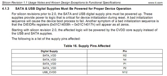

  • Some earlier revisions of DA850 parts were DSP boot devices, if you provide us the entire dump of the GEL file we can look more into this and confirm your observation. In case you are looking for an DSP UBL that wakes up the ARM, you can use the DSP UBL from OMAPL137 to wake up the ARM and executes the ARM UBL.

    By the way, I’ve tried to use OMAPL137’s DSP UBL before. But it failed because of my ARM UBL is AIS file format. And I’m lack of ARM UBL in raw binary format. So could you provide one for me? Thanks a lot.

    From the debug GEL file, there is something weird, we are observing in the device info. On a normal device, the device info shouldn`t turn out to be zero. Are you using a custom board or the evaluation module for your development? If this is a custom board are you applying power to the USB/SATA pins?
    Rahul
  • Thank you so much for your reply again. I've burnt these 3 boot files sucessfully. However,there's no printout in the HyperTerminal window after I changed my board into NAND Boot Mode.
    This is a custom board designed by myself. And it has no USB port. So I didn't supply power for USB.But I do apply power to the SATA pins. Is this the key reason why my board couldn't work well?
    Cicy

    What is the version of the PSP release you are using ? OMAPL138 is an ARM boot device so I am not sure why you are using a DSP UBL? could you specify the function of each of your boot binaries.
    Rahul
  • Hi Oscar,
    My problem has been solved by changing the version of my 138 chip into V2.0 because of I didn't supply power to its USB pins.And you could find out the reason in details in its <<silicon errata.pdf>> file as follows:
