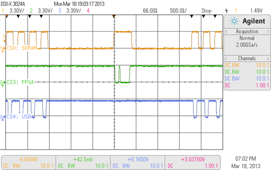

 I am working on our custom design that contains a C6748 (@456MHz) and a Cyclone IV FPGA that is connected to the EMIFA. Via CS3 I can access several registers on the FPGA, via CS4 we can do USB-communication. I wrote a none-bios-application that polls our USB-communication in the main-loop, works nice.
I have set up a timer that generates Interrupts with 10kHz. When the interrupt occurs, the DSP reads and writes some registers on the FPGA, that works too. But when I watched the different chip-selects by oscilloscope to determine the workload of the EMIFA, I saw a big latency in the execution of the timer-interrupt. I attached a screenshot of the oscilloscope.
 You can see the polling of the USB-connection in blue, then the interrupt occurs, but there is about 1500ns stall where nothing happens on the EMIFA. Then there are the read/write-operations on the FPGA and another stall afterwards. I tried nearly everything I could imagine, but it doesn't change much (Debug<->Release, optimizations, inlining...).
The main-loop solely consists (after the initialisation) of a while(1) that polls the USB-connection via a HWREG(). In the interrupt I followed the starterware-examples to reset the flags (TimerIntDisable, IntEventClear, TimerIntStatusClear) and only do 2 operations on the EMIFA , also via HWREG(). By the way, the program is in L2RAM located.
Does anyone know the origin of that latency and/or how to remove it?
Chris
  • Chris
    What is the relationship between CS4 and USB? When you say USB connection in blue, are you saying USB is connected to a host and starting to send/receive data? CS is an active low signal, so the 1500ns you are seeing could be the read/write operation, not the stall.

  • Hi David,
    Sorry for not explaining that. We have one FPGA connected to the EMIFA that gets the CS3 and CS4-signal. Among others the FPGA provides a custom USB-Connection which can be accessed via CS4. So in the first 1000ns of the screenshot the polling of our USB-connection can be seen, where the DSP (currently no DMA or so involved) checks if data, that came via USB, is present (in other words we check our fifo's "used words" in the FPGA if it is non-zero).
    Then the timer-event occurs that is mapped to INT4 of the DSP-core. There we have that stall of 1500ns before we can access the FPGA again (this time via CS3) to service our real-time-control in the interrupt-routine (for frequency converters and gear like that). I didn't try it yet, but it seems to me that I could get a better performance if I polled the interrupt-flag. But that seems so wrong to me... (at least for the real-time part)

  • Kai,
    From your scope screen shot, it looks like there is an extended memory access period to SDRAM via CS0 on timer interrupt. Do you have a similar screen shot with the GPIO pin toggling? We do not have numbers for interrupt latencies, but they are not very significant - more so that this is a non-BIOS application - so BIOS scheduling also does not come into the picture.

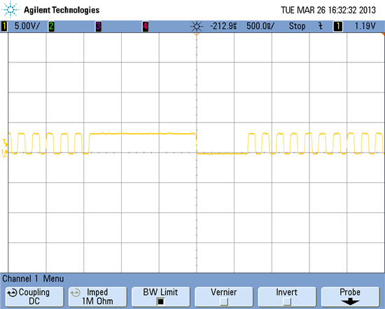

  • Sunil,
    I provoked the behaviour that Kai mentioned. See the screenshot below. I used a standard GPIO with the starterware-functions like GPIOPinWrite(). The main-loop only toggles the GPIO, the interrupt forces the GPIO low. The same delay-time of about 1500ns can be seen.
     I tried to implement your hints to increase performance, but it didn't help yet:
    1) EMIFA is configured to 100 MHz, SDRAM-timing-settings coincide with the datasheet (IS42S16160D).
    2) I tried CacheEnable(L1PCFG_L1PMODE_32K | L1DCFG_L1DMODE_32K | L2CFG_L2MODE_64K); from dspcache.h from the starterware. It shortened the delay by about 100ns, not as much as I hoped. Following the Reference-Manual of the TMS320C6748 (SPRUH79A) chapter 4.2 the default configuration of L1P and L1D already is cache. Does that mean that it is also used? Or do I have to tell the DSP over again to use it (you wrote "and turn on cache")?
    3) I set the DSP_CFG-priority to 0, SATA and UPP to 7 (we don't use them) and left the DMA at priority level 2. Sadly no change.
    4) We don't have DDR2-RAM on our board, all our applications fit into L2 SRAM. In my opinion this should bring a even better performance, because if the DSP can't fetch a instruction in L1P it is at the latest found in L2 and not further away. SPRUFK5A chapter 2.4.1 says: "On a program fetch, if the tag matches and the corresponding valid bit is set, then it is a "hit", and the data is read directly from the L1P cache location and returned to the CPU. Otherwise, it is a "miss" and the request is sent on to the L2 controller for the data to be fetched from its location in the system."

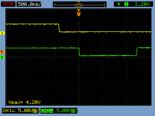

  • Hello Sunil and Kai,
    I tried another setup to measure the latency between the occurance of an interrupt and its ISR. I simply configured an external GPIO as input- and interrupt-pin (falling-edge). At the beginning of the ISR, the DSP clears another GPIO to 0, does its control-task and rises the GPIO back to 1. Here the latency is no longer as long as it was before, just about 800 ns.
     Below is a screenshot that shows the timing. The yellow signal is the trigger, the green one is the "answer" in the ISR.
    Unfortunately, this improvement is quite useless to us, as we mainly operate through the EMIFA to get and set all the values (actuating variables etc.).
