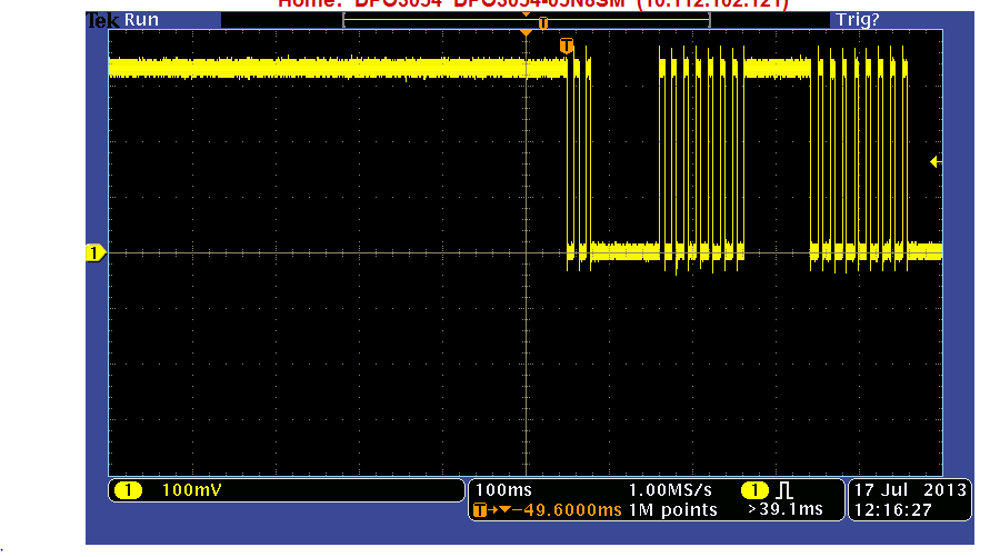

    However, the glitches observed when making the change to the duty cycle still remain.  I probed the PWM output of the OMAP and I can see that every time I change the duty cycle there is a short period of time when the output is pulled high or low.  The image attached shows a scope capture of the PWM output. The periods where the signal is consistently high or low are points where I request a change in the duty cycle.
    I tried disabling the internal pull up resistor on the PWM signal and this had no effect on the behaviour.  It seems to that the PWM module relinquishes control of the signal at some point during the update.  Any suggestions on how to eliminate this glitch?

  • I looked into this a little more and it turns out that the default setting for the emulation mode bits in TBCTL is causing the glitches.  If I set these bits to Free Run mode (02h) then everything seems to be fine.  The problem seems to be fixed but some explanation about what's happening under the hood will help.

  • Hi Dinesh,
    Thanks for the update. Please find my analysis on this.
    0 - It stops the PWM output when there is a change in TBPRD (That is next time base counter).
    1 - It stops the PWM output when counter completes a whole cycle on selected mode.
    2 - It never stops the PWM output.(Free run)
    FREE, SOFT:
    0h - Stop after the next time-base counter increment or decrement
    1h - Stop when counter completes a whole cycle:
    • Up-count mode: stop when the time-base counter = period (TBCNT = TBPRD)
    • Down-count mode: stop when the time-base counter = 0000 (TBCNT = 0000h)
    • Up-down-count mode: stop when the time-base counter = 0000 (TBCNT = 0000h)
    2h-3h Free run
    Reference to EHRPWM Linux Driver:
    I have checked the LCD brightness control on OMAP-L138 linux using EHRPWM driver. The PWM should be enabled in Free run mode.
