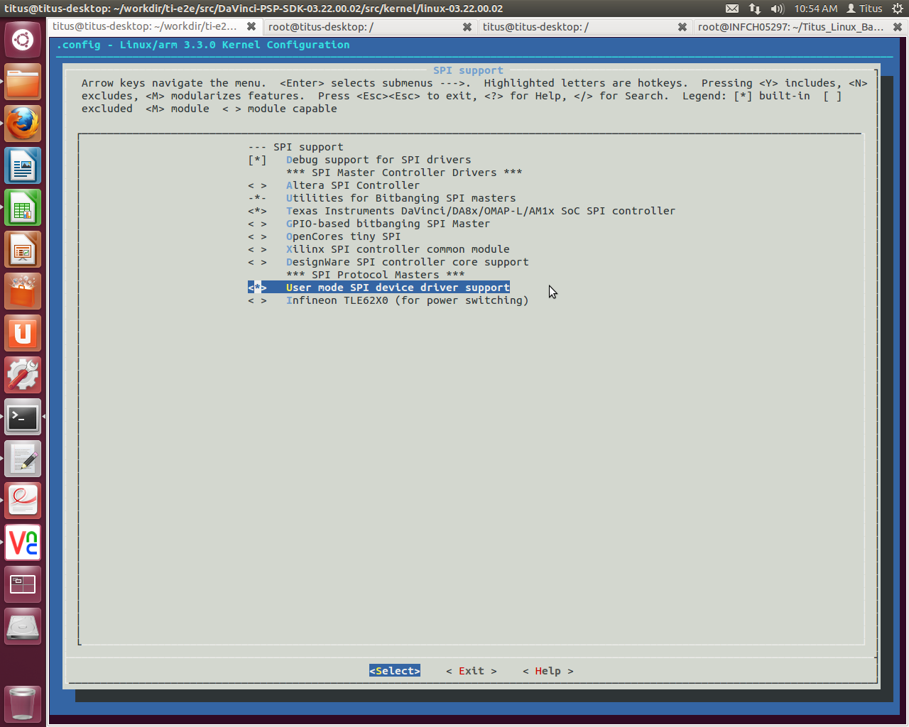

    Firstly I try to кгт SPI driver on LCDK.
    I set CONFIG_SPI=y in .config and modalias = "spidev" in board-da850-evm.c. as it says in documentation/spi/spidev
    But I can't see any /dev/spidev, when I run new kernel.
    How did you configured SPI in linux kernel?
    Whether using "menconfig" or diretcly editing the .config file?
    Use always for kernel configuration,
    make menuconfig ARCH=arm CROSS_COMPILE=arm-arago-linux-gnueabi-
    Today I configured SPI with menuconfig. (Choose everything in Device Driver->SPI support.)
    Loaded kernel to LCDK and couldn't see spidev in /dev.

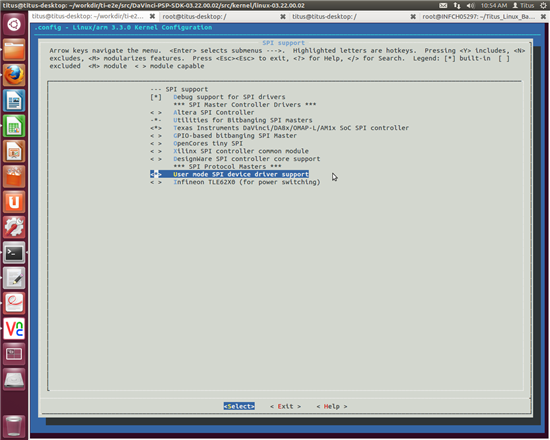

    Can you please ensure that you have enabled "User mode SPI device driver support"  (CONFIG_SPIDEV) support in menuconfig for SPIdev support,
    SPIdev support is for accessing the SPI from user space.
    If still you could not see then it could problem of udev population,
    So Try to create node manually and do your experiments,
    Also, the node should be something like /dev/spidevX.Y,
    where X is the bus no and Y is the chip select
    e.g. /dev/spidev0.1

  • I have choosed every menu item in SPI support section.
    I manually made spidev1.0 (mknod spidev1.0 p).

    Finally I got your problem,
    From MCSDK, I also could see three *.o board files if I configured to OMAPL138 LCDK,
    So, I would like to suggest to you that Please download appropriate source code for OMAPL38 LCDK which is available from below link.
    From OMAPL138 LCDK  LINUX SDK source , If you configured the linux source code for the OMAPL138 LCDK then the appropriate board file would be "board-omapl138-hawk.c"

    So, Use OMAPL138 LCDK SDK and do the pinmux for SPI to avoid confusions.
    You can refer the old e2e post for SPI pinmux which i gave previous post.
