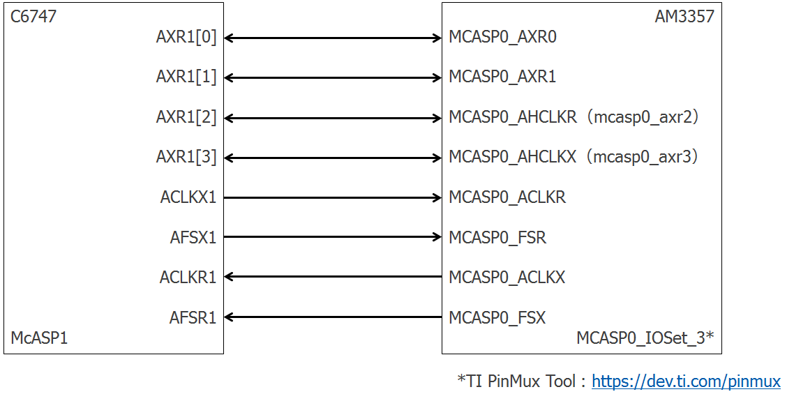

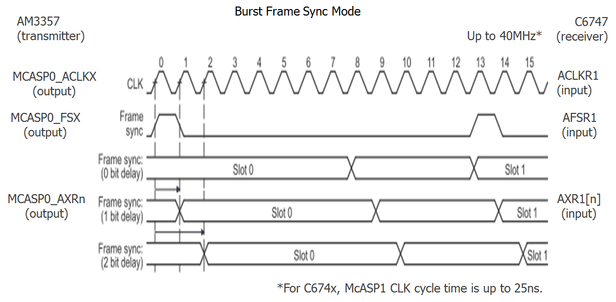

Our customer wants to connect via McASP between C6747 and AM3357. Unfortunately the terminals for HPI which C6747 has are used for EMIFA.
I checked the following posts. It seems to be able to connect between two McASP ports because McASP is available as a general-purpose serial ports.
 http://e2e.ti.com/support/dsp/tms320c6000_high_performance_dsps/f/115/t/91177
 http://e2e.ti.com/support/arm/sitara_arm/f/791/t/195077
Is there any information to implement this? Are there the application note and the sample code?
