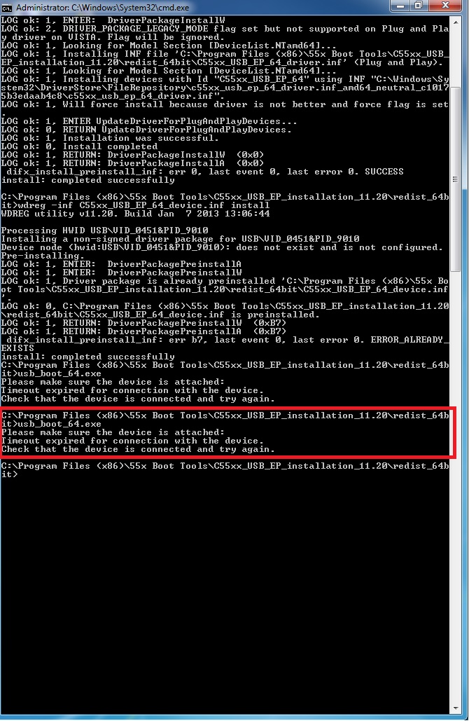

  • Dear Steve;
    Thank you for your reply.
    We applied  the steps up to step #4.After running usb_boot_64.exe we got the following message:
    We are working on TMS320C5515 EVM from Spectrum digital.At step 3 of the readme.txt ,J11 port of the board was connected to PC ,not J2 (mini usb for Emulator)
    Please find another capture of PC related to Device manager:
    How can we fix this problem?
  • J11 is correct. Have you set the "Disabled Driver Signature Enforcement"? If you are using C5515 EVM. make sure J15, USB_VDD_IN is powered by on board V1.3 (2-3). This is my usb_boot_64.exe screen:

  • Dear Steve;
    We made JP15 connection to supply USB_VDD1P3, USB_VDDA1P3 externally.We have 1.295V at pin #2 of JP15. Bu still getting the timeout error:
    We use Win7 64 bit.We tried your suggestion on both TMS320 and TMX320 (We have 2 evms one having TMX and other having TMS) .Problem still exists.We also tried to uninstall and reinstall the driver .
    Any comments?
    BR
  • I have a Dell Latitude E6430 with Win7 64-bit. Not quite sure what cause your problem. Have you confirmed there is no valid boot image in other peripherals? USb is the last one after all other peripherals are checked with no valid image. The other thing to try is different PC's USB port.
    Good luck.
  • Steve;
    We finally succeeded to run usb_boot_64.exe. We are not sure how it did happen but we are suspicious about some driver issue.When TMS320C5515 is not connected,Jungo shows only "C55xx_USB_EP_64" .After plugging J11 connector to PC's USB port, an icon named "DEVICE" appears under "C55xx_USB_EP_64".Then We are able to run usb_boot_64.exe.
