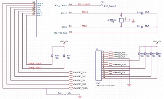

I've developed an audio processor using the TMS320c5505. Wich JTAG can I use to upload and debug the software? I left all JTAG pins the same way it was on the usbstick Kit (see schematic). Will the TMDSEMU100V2U-14T work for this? Can it be used with CCS V.4?

    The TMDSEMU100V2U-14T will definitely work with CCS4 (for free!) - the 14 pin version is what we use to debug our EVMs.
    The eZdsp uses an on-board version of the XDS100 emulator, but the TMDSEMU100V2U-14T emulator requires the 14-pin JTAG header to connect to the JTAG signals. There is no header on the eZdsp because the signals go directly to the onboard XDS100 and then to USB port.
    You would be better off referring to the JTAG schematics of the C5515 EVM, which has a JTAG header. Just make sure that the signals are in the same pin locations of the JTAG header (looks good) and the pull-ups & pull-downs match...
    You can ignore the embedded JTAG part of the EVM, and just strip out the J8, the 14-pin JTAG header, and the connections to the DSP. Notice that TCK is shorted to RTCK at the JTAG header (pins 9 & 11). We also have an additional 15pF cap on TCK close to the DSP pin. And we use 100K pull-ups on EMU0 & EMU1.

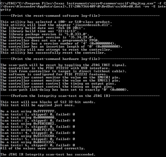

    Hardware Diagnostics:
    Pin TCK & RTCK: Clocking 1MHz
    Pin TDO: There is some Data...
    Pin TDI: There is some Data...

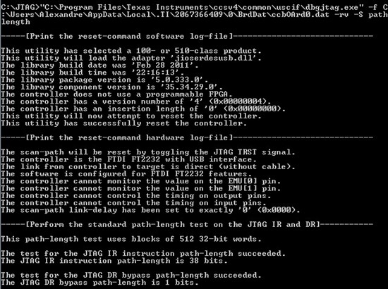

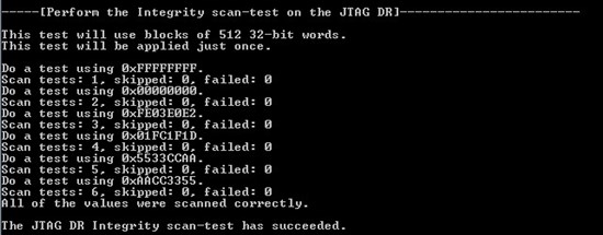

    dbgJtag:    pathlength
    dbgJtag:    integrity
    Please ask for more info if you need.
    Alex
  • This looks the same as the configuration I have. Also, since your dbgjtag tests all passed, it means your hardware and low level JTAG drivers is working through to the JTAG TAP. For some reason, when you press connect, the core is not responding, which is causing the error. I assume you tried resetting the hardware, there is no ready signal being asserted, etc.
