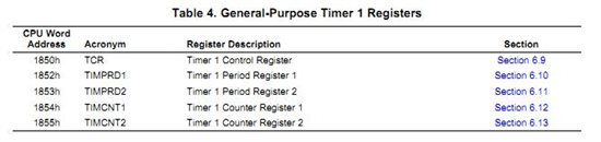

I cannot find this in the Timer User Guide (sprufo2). Here are the registers listed in the guide.
The other pertinent register is the timer interrupt aggregation register, which is located at 0x1c14h.
However, when I reset the Timer 1 interrupt bit in the TIAFR, the TIMINT bit does not get reset.

    That TIMINT register (0x1816@IO) is a superfluous register that has been replaced by the TIAFR - 3 timers share one interrupt & this register decodes which timer fired the interrupt.
    We caught and deleted TIMINT from the documentation long ago, but we had not deleted it from the CCS4 register view yet.
    Thanks for bringing this to our attention. I have filed a bug against it. We will fix it in the next release.
