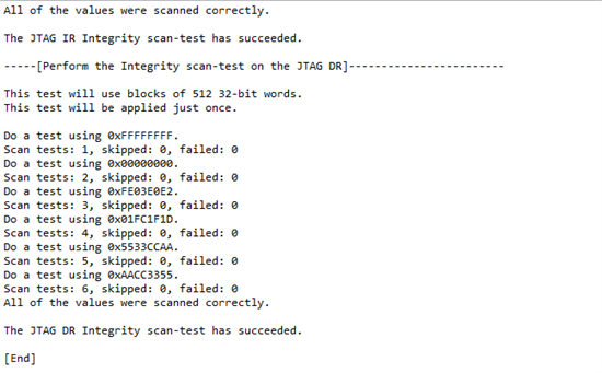

Firstly,  I want to confirm one thing :   my C6745 platform has passed connecting test with my emulator (XDS560) .
     Assume I have already configured the PLL0 correctly , Does the DSP core portion begin to run correctly  at currently ?
     what the real status of DSP we can judge from the JTAG connecting test success  ?

    1.  what's the DSP core portion working status when connecting(amulator and device) test has successed ?
         Does it means DSP core portion has begin to work after JTAG testing PASS ?

    The JTAG scan-test only tests the JTAG scan chain of logic that allows access to the cores and other components. The JTAG scan-test does not directly use or logically connect to any of the cores.
