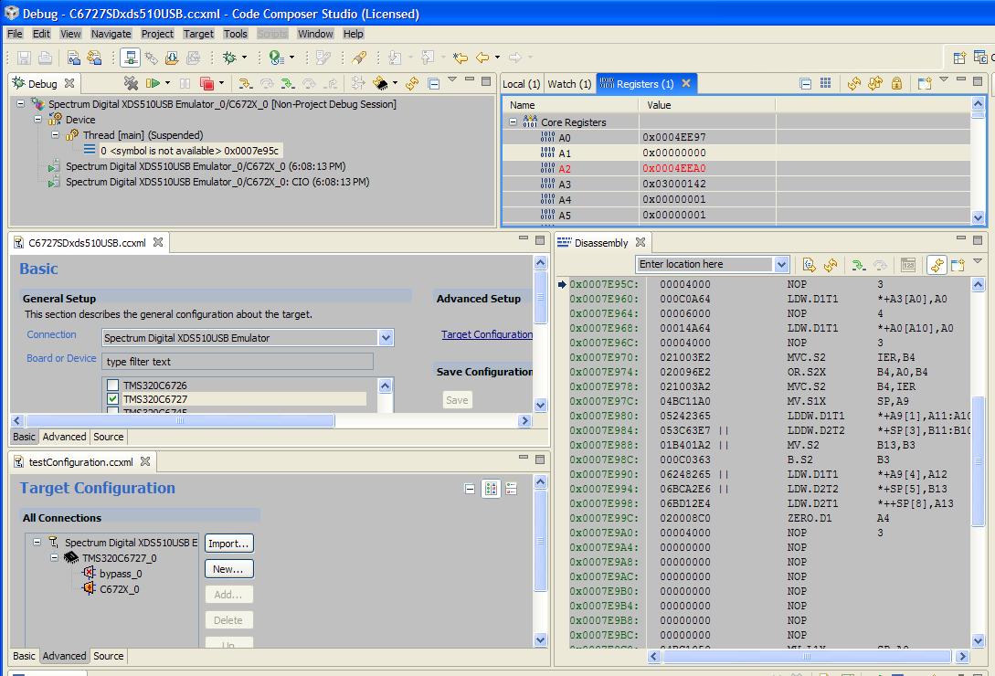

  • Which XDS emulator are you using?
    I was able to connect a very similar TI C6727-based board (I have used almost interchangeably with PADK in the past) with Spectrum Digital XDS510 USB and CCSv4.1.0
    Please see the attached screen shot of the .ccxml file (c6727 check marked).  The Advanced Tab is shown in another window below to show the bypass that need to be in the file, similar to CCS3.3.
    Starting with View->Target Configurations seems to work best for me with CCSv4 (and later link the .ccxml file to a project).
    Also I did run the SdConfigEx v4 Icon that shows up on your Desktop after CCSv4 install.  It enumerated USB and reset (like I have done with CCS3.3)

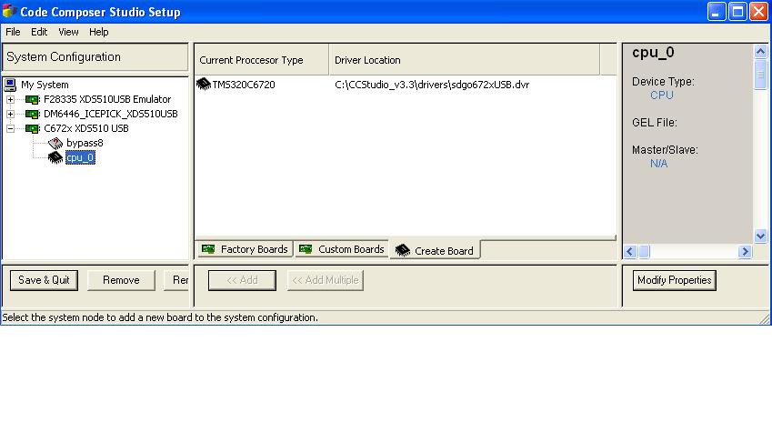

             I hope you may work with LYRTECH PADK with XDS510 USB emulator using CCSv3.3 can you please help me... I am having some problem on working on that...
     I am working with LYRTECH PADK C6727 350MHz When I tried to connect the hardware using USB I am getting an error while installing the driver, I follow the procedure from get start guide.
    When I select that ltpadk_usb.inf file it shows The specified location does not contain ant information about your Hardware.
    So I tried with XDS510USB emulator in that when I test the emulator I am getting this message
    ** Using emulation application from directory c:\ccstudio_v3.3\drivers
    **Emulator is reset
    ** Checking for a valid emulator/eZdsp
    $$ You are connected to:
    $$ EmuProductName=XDS510USB
    $$ EmuPortAddr=0x510
    $$ EmuPortMode=USB
    $$ ProductId=510
    $$ ProductVersion=84
    ** Checking emulator/eZdsp scan connection
    ** Emulator Test **
    $$ EmuPortMode=USB
    $$ ProductId=510
    ** Emulator Scan Test
    -- Found JTAG IR length of 10
    -- Found 1 JTAG device(s) in the scan chain
    Here I am getting the JTAG IR length of 10 and only 1 JTAG device found in the scan chain. But it should be length of 54 and 2 JTAG device.
    After this I try with CCS3.3 and XDS510USB emulator it shows the following error...
    error Connecting to the target:
    Error 0X80000200/-163
    Fatal error during: OCS,
    BAD Target silicon revision number
    The number of devices in JTAG scan path
    must be correct for the silicon revision to be read.
    Or, you may have selected the wroing DSP device driver
  • SDConfig output shows you are talking to the board.
    I'm not sure what that file is.
    I no longer have a working CCSv3.3 but the attached screenshot of CCSetup did work. I remember that the driver name and order of bypass vs. CPU was important.
    Also in sdopts.cfg you needed to have the firmware line uncommented for the right XDS port number:
    #Only override the EmuFirmware when specificly required to support new
    #or custom TI devices.  Then only use the settings which will be documented in the
    #driver release package.
    EmuFirmware=sdxds510usb_v10_1.out
