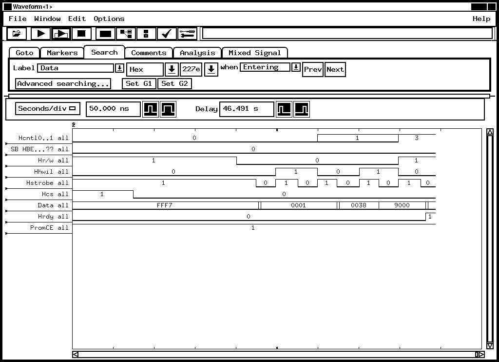

I have a 6713 design where some HPI reads from the CE1 address space (0x9000 0000) cause the HRDY signal to stay high.
All the writes to the HPI from the host (a FPGA is the host side of the HPI) seem to work fine. After writing, I try to read (often from the same address as a write) and some times the read works fine, and sometimes HRDY stays high indefinitely. If I do multiple reads from the same address, I may get one or two good reads in a row then it will fail.
I've looked at signal integrity (on the HDS1 signal) and timing and don't see any questionable issues. The implementation is HDS2 and HAS are tied high and HDS1 is used for the strobe. The protocol, as I read the 6XXX HPI reference guide, is correct, and the same for the good and bad cases.
The only way to clear the HRDY signal after this happens is to reset the DSP. If I restart the DSP and repeat the sequence of writes followed by reads, the behavior is the same.
Any ideas on where to go from here?
  • I have attached a logic analyzer diagram
    The sequence of HPI activity is this:

    Thanks for the responses.  The main reason behind the questions is to have a better understanding on whether the issue is isolated to the EMIF or the HPI.
    After talking to some additional experts, the HRDY will go low during a read access until the requested data is loaded into HPID.  If data does not get loaded, the HRDY will continue to be high indefinitely.  This can occur when the address being accessed is reserved, or when the EMIF is not configured correctly.
    To determine if this is an HPI bus error, can you try writing to a L2 memory location and then reading back that same memory location?
    To determine if the HPI is not accessing any reserved memory location, can you try probing the data lines to see if it is sending out the correct address?
    To determine if the EMIF is configured correctly, after executing the first two HPI writes to the EMIF controller, can you open a memory window in CCS and write another data value into the EMIF memory location?  After writing, can you refresh the memory window a couple of times to make sure that the one memory location remains the same and doesn't affect any neighboring memory location?
    Christina

    the 6713 HPI strobe must be asserted at least 4 CPU cycles, and also de-asserted a minimum of 4 CPU cycles between accesses. In HPI boot mode the PLL will start in bypass mode and the CPU will operate at the CLKIN frequency. At 20MHz CLKIN for example, the HPI strobes must be > 200ns. From your LA screenshot it seems you are using 25ns strobe width, which would require a CLKIN of 160MHz or higher. Is this condition satisfied?
    Another issue I struggeled with some time ago: only the 6713B devices work correctly with strobe width of a 4 cycles. The older devices (without B) require a 10 CPU cycle read strobe.
     -- A. Klemenz
  • Hello A. Klemenz,
    We are running a 40MHz clock so the timing is wrong and we will correct it.

    The 6713 data sheet defines the HPI timing: HSTRB must stay active at least 4 DSP clock cycles = 100ns if the DSP runs at 40MHz. Between HPI accesses an idle time of 4 DSP clock cycles is required, i.e. HSTRB must be de-asserted for 100ns minimum. This idle time is required between *all* HPI transfers, even between first and second half-word transfers. The destination or source memory accessed on the DSP has no effect on this basic HPI timing.
    HPI strobe is not a clock source, it is an asynchronous input. Internally the DSP will synchronize the HPI signals to its clock. This is the reason for the 4 cycle minimum constraint. If you violate this timing the DSP may not recognize the HPI access correctly.

  • Hello A. Klemenz and Christina,
    We have now corrected our timing and are able to get correct read/write to the HPI.  We have more work to test full functionality however, the help that you provided got us past the primary issue.
    Thank you.
