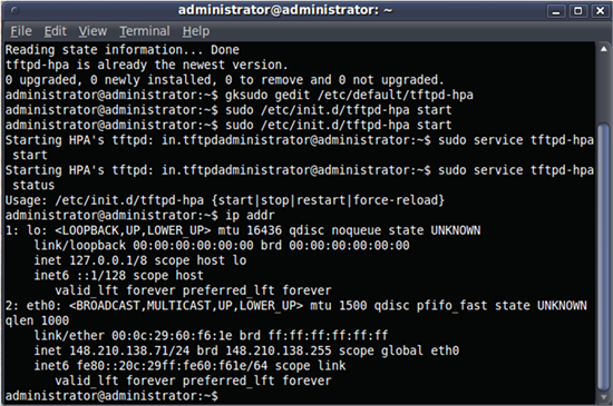

I want to load uImage to the nand using tftp server on linux, so when i ser the variable serverip i put the ip i have on linux, and i specify what file with bootfile, by the way, that its uImage-dm6467t-evm.bin, and yeah, i alredy installed tftpd-hpa into the host, and the tftpoot folder its in /var/lib/tftpboot, i have the image there, and the tftp server its supposly running. When i try to boot with the command tftpboot from the board, a message says that i must first set an ipaddr variable, but like i say, i dont know what ip to use, im gonna put some images, and i know that my question is probably easy to find, but i dont dont know if its an ip problem, or a connection problem, because i need internet to run VMware, so i installed another PCI with ethernet, and the two of them work (supposdly), also im using an crossover ethernet cable, between the board and the PC, because i read on many post that the dm6467t only work with this cable, but i have the another too, just in case. Im following the steps on this post

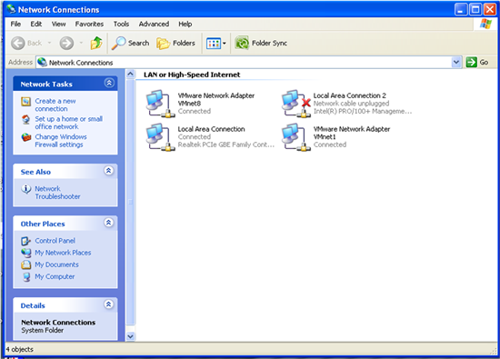

im on step 3, and he puts an ipaddr, but he says he get it from a router he had, and im not uing a router to get internet, here are some photos of my ips
The network with the 'X' its the one i have connected with the board, and it gets to limited or null connection when i turn on the EVM.

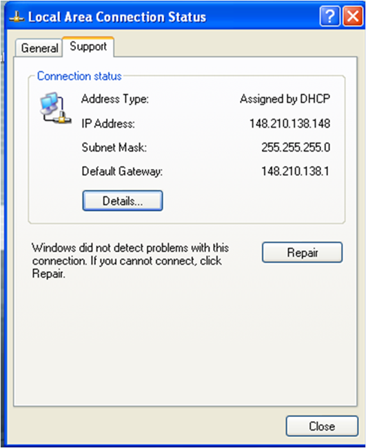

  • Thanks Brandon for the reply, but how i make sure that my PC is running on a network that has DCHP server?? and how i make sure that the same is happening in linux?? youre telling me that both of them must have the same IP in DHCP too??, im most certain that i have DHCP, because in my network connections it says so, but im adding pictures again to give you a more detailed perspective of how im working, if you have a wiki telling me how to configure networks itll be great too
    well, that last picture is the enviroment im working, a windows host, with an ubuntu virtual machine in VMWare, when i set up the network connection in VMWare i set it to bridged in the options, the other network connection that appears at the bottom, its the one the dm6467t its connected, when i turn it on, it changes de X to the warning connection, displaying that little or no connection its in that network, thanks in anticipation
  • Based on what you have provided, your network does have a DHCP server.
    I didn't say the Windows PC and the Linux Virtual Machine running on it must have the same IP address.  In fact they should not.  What I indicated is they should be on the same subnet, in your case 148.210.138.xxx.  Ultimately, the DM6467T EVM will need to be on the same subnet, with a IP address in the 148.210.138.xxx where xxx is 0 to 255.

    this is a second try, but now i turned on the tftpd-hpa server, but again, nothing happen
