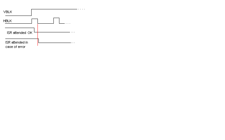

    We are using an scope for monitoring input signals and they are working fine. Also, we are using several GPIOs in order to visualize when an error ocurrs and the VP1 interrupt periodicity.
    When an error ocurrs the VP1 interrupt is attended very closer to a falling edge of HBLK (first HBlanking after VBlanking starts). ISR is attended after that falling edge. When all is ok the ISR is attended after or before the falling edge of HBLK but it is never very closer to the falling edge of HBLK. I don't know if it could be related to our problem. I would like to test VP1 behavioural using VPORTCAP_HRST_START_HBLK instead of VPORTCAP_HRST_END_HBLK but it doesn't work fine. For that purpose, we are using the following configuration for BT656 (PAL mode):

  • Thank you for your answer but we can not use embedded syncs.
    It looks like a VPORT or DRIVER issue. When video capture ISR is called near the falling edge of hsync YPOS doesn't have the right value, FID has been updated with a new value but YPOS keeps the same value.
    We have solved the problem reading the value of YPOS and FID after an XPOS change (it should be 1 cycle of VCLK at 27MHz aprox.).
    For this purpose, we have modified vport library and it works properly.
