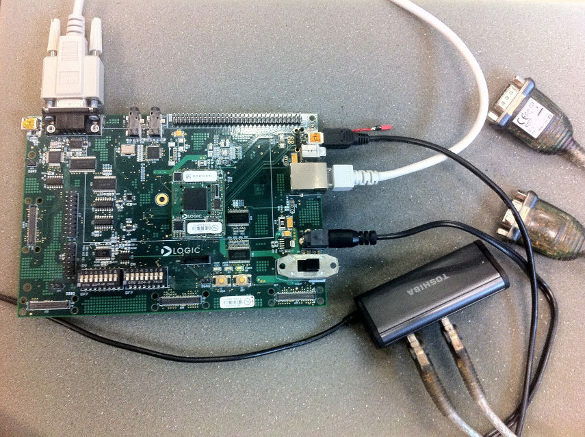

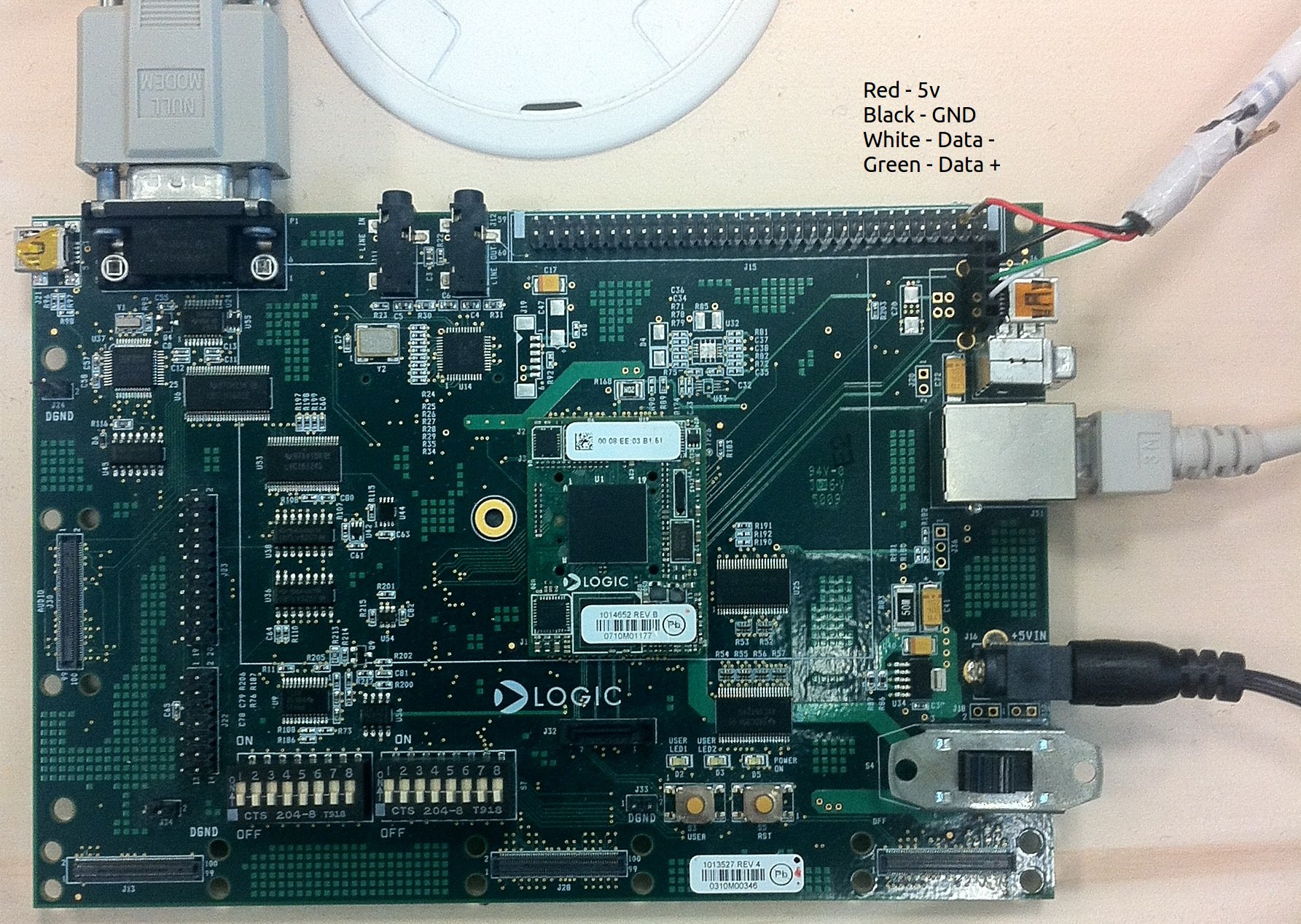

    We are using a connector to be able to test. Attached is a image with the setup.
  • Anibal,
    I suspect the problem is with your USB connection.
    You need to use a USB Mini A cable. See attached pictures.
    Carlos
  • Thanks for the tip, with the right cable and after inserting the g_ether.ko module we can detect the devices.
    With kernel 2.6.37 it worked because the port was forced to be host.
    Our original problem is still present though. When we connect an usb hub to the 2.0 port, and then connect two usb to serial converters to the hub we get the following errors after opening the ports with microcom simultaneously:

    Can you try a hub with 2x one port serial-to-usb converter ? It gives the same error ...
    I have attached an image to be clear the setup that we are using.

  • We purchased all the mentioned hardware items and carried out the testing.
    I have done the same test as jose mentioned in his previous post.
    "Able to successfully open the two ttyUSBx ports of USBSerialconverters via SMSC LAN9512" without any problem ; even before and after configuring the Ethernet port of SMSC. Attached the snapshots for your reference. In the attachment, the teraterm and putty windows will show that the ttyUSB0 and ttyUSB1 ports were opened.
    Setup
    • arago linux-davinchi 3.22.02 kernel 3.3.0
    • Config: da850_omapl138_defconfig with usb gadget support, usb serial adapter (prolific) support and SMSC LAN95XX support.
    • No USB Patch was applied in any of the tests
    • uImage loaded using nfs
    • Filesystem loaded using NFS
    Test Configurations
    a) Toshiba HUB connected to EVM; 2x usb pens (1xLexar, 1xcardreader) connected to Hub;
    b) Toshiba HUB connected to EVM; 2x usb 2 serial converters (one from prolific and other one is a Taiwan product);
    c) EVM connected to SMSC Lan9512EVM; 2x usb 2 serial converters (one from prolific and other one is a Taiwan product); RJ45 Ethernet cable Connected;
    d) EVM connected to SMSC Lan9512EVM; 2x usb 2 serial converters; RJ45 Ethernet cable Connected.
    Test Description
    a)
    • Connect the Hub to the EVM after login;
    • Connect the two Pen Drives, one at a time;
    • Disconnect the two Pen Drives, one at a time;
    • Re-connect the two Pen Drives, one at a time.
    b)
    • Connect the two usb to serial adapters, one at a time;
    • Open two SSH sessions to the EVM;
    • Open with microcom one usb to serial adapter on each SSH session;
    c)
    • Connect the SMSC LAN9512EVM to the OMAP_EVM after login;
    d)
    • Connect the RJ45 cable and check connection;
    Result Summary
    a) No Problems;
    b) No Problem. Able to open the second serial port successfully;
    c) No problem; Able to open the second serial port successfully; Able to configure the Ethernet Port of the SMSC LAN9512;
    d) No Problem occurs when opening the first and second serial ports;
    ( if needed I can share the .config file and the kernel Image )
    Shankari
