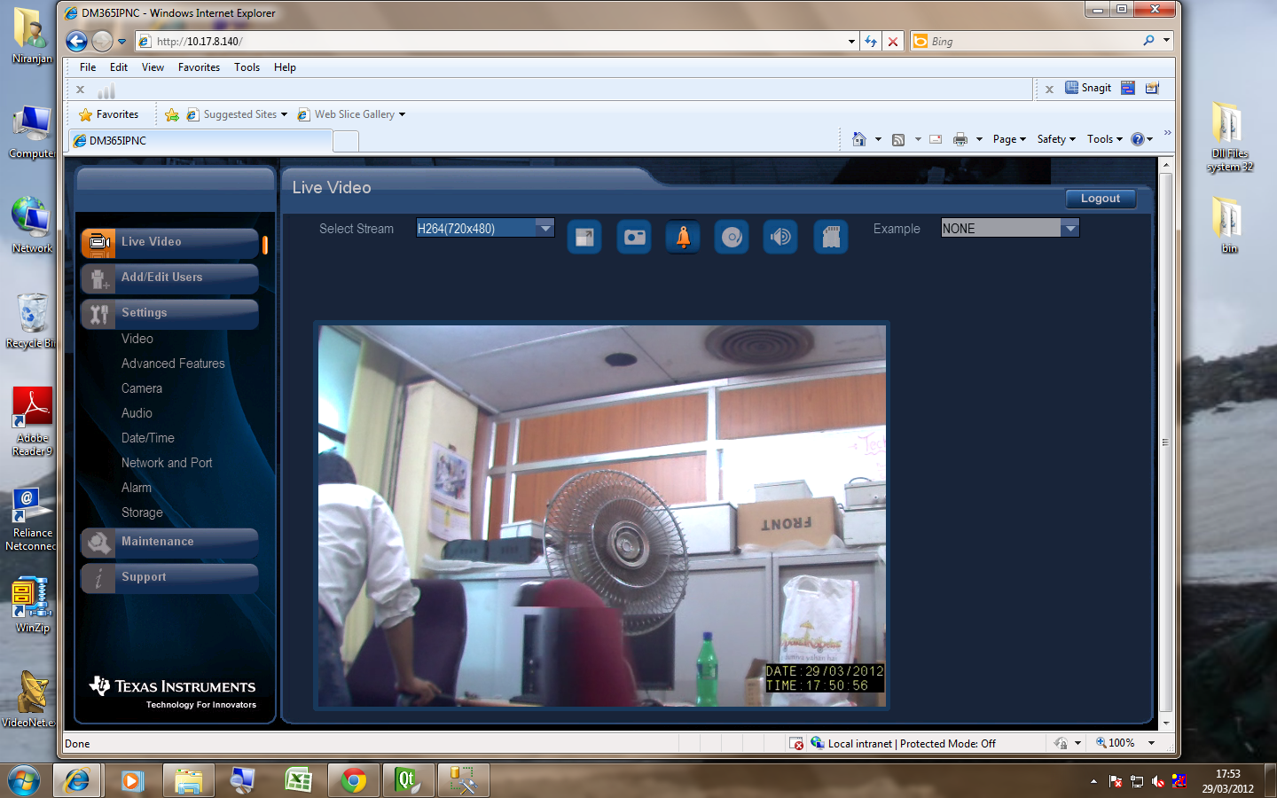

  • Hi Anshuman,
    I am also facing the similar Image tearing issue.Please find the attached image.
    I tried changing the    params.ipipeif_param.clk_div          = DIVIDE_SIXTH
    to DIVIDE_THIRD but i was getting the same image tearing issue.
    Please also find the dump of IPIPE and RESIZER registers below:

    In my case image tearing comes in ISIF_IN mode D1 resolution in every codec.
    I tried changing the synchronization register of resizer but that also was of no help.
    Could you suggest anything to focus in order to solve this issue ASAP.
