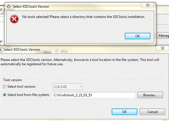

I got this warning: "Description Resource Path Location Type This project was created using a version of XDCtools that is not currently installed: 3.23.3.53. Please install the XDCtools of this version, or migrate the project to one of the supported versions. McBSP_EDMA3  McBSP_EDMA3 TI Problem Marker "
Initially, I create the project using 3.23.2.53.  Then I installed xdctools_3_24_05_48.   In RTSC tab, I have 3.24.5.38 active.    I still have c:\ti\xdctools_3_23_03_53 intacted.
1)  I am unable to install 3.23.03.53.  2)  How to migrate the project to 3.24.05.48?

  • Hey Steve,
    This error occurs when CCS can not find a valid XDCTools installation within the c:\ti\xdctools_3_23_03_53 directory.   Perhaps you can try re installing xdctools_3_23_03_53 and then retry.  To migrate the project to 3.24.05.48  right click on the Project and select Project Properties and under the General->RTSC tab within the Properties dialogue you can select a new XDCTools version.

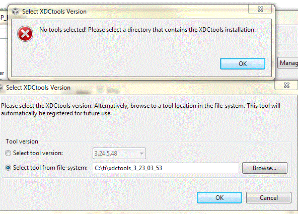

  • Hi Branavan,
    It is already shown new XDCTools version 3.24.5.48.  See below.  Thanks.  Steve
