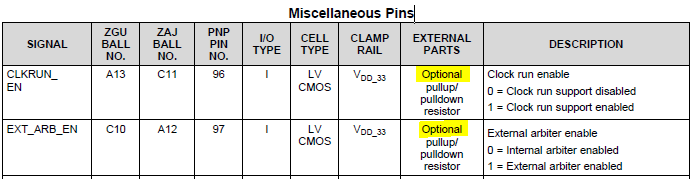

in one of our designs, we left CLKRUN_EN and EXT_ARB_EN unconnected since the documentation showed internal pulldowns.
Unfortunately, the XIO2001 erratas (scpz008b.pdf) from 2012 tell us that these internal pullodwns do not work. The recommended workaround is to connect external pulldowns to these pins.
But adding these external resistors is no option for all boards already produced, since the we use the XIO2001 in a BGA package.
In contradiction to the errata, even the actual data sheet from 2016 talks about internal pulldowns on these pins (note 1 on page 20):
And until now, we had no issies with the XIO2001 that could be related to CLKRUN_EN or EXT_ARB_EN effects.
Is there perhaps a new chip revision already available that fixes this errata?

    This means that even the XIO2001 data sheet from 2016 is incorrect, as
    • The external Pullup/pulldown resistors for CLKRUN_EN and EXT_ARB_EN are marked as "Optional" in the pin description table (page 13)
    • In chapter 6.10 on page 20, footnote (1) indicates that CLKRUN_EN and EXT_ARB_EN have intenal pulldowns
    • On page 118, it is described that CLKRUN_EN and EXT_ARB_EN are sampled with PERST# deassertion.

    After checking with designer, it appears that EXT_ARB_EN and CLKRUN_EN are not latched upon reset as I was told initially. They are monitored continuously as you have observed. Sorry for the confusion.
    Yaser

    As the answers to my questions are spread over several postings, I will summarize them here:
    • CLKRUN_EN and EXT_ARB_EN have no internal pullups or pulldowns.
    • CLKRUN_EN and EXT_ARB_EN are inputs that are never sampled or latched by the XIO2001.
      They are NO static control pins.
      Whenever the input voltage at these pins changes, the XIO2001 will change it's behavior.
    • Anything in the data sheet or errata note that indicates something else is simply WRONG.
    • There is no new chip revision available that would fix this misbehavior.
    • Is it NOT possible to overwrite the CLKRUN_EN and EXT_ARB_EN pins with an appropriate EEPROM content.
    • The activated CLKRUN feature can't be detected reliably by reading SEC_CLK_STATUS because SEC_CLK_STATUS only shows if the secondary clock is running or not.
      But this does'nt matter as such a detection is quite useless in any case, since a floating CLKRUN_EN pin can turn the CLKRUN feature ON and OFF at any time.
    • The pin GPIO0 has a pullup then the CLKRUN feature is enabled. This typically leads to a stopped secondary clock as soon as the CLKRUN feature is enabled.
    One personal remark:
    On our boards, we observed that CLKRUN_EN always floats to ground. This behavior was temperature independent. But TI says: It can float to VCC or ground.
    Due to the ball location of EXT_ARB_EN, it was not possible for me to do the measurement on this signal too.
    Regards, Niels
  • Hi Niels,
    Thanks for the summary. The bottom line is a pull-up or pull-down is required for each of these 2 pins.
    Yaser
