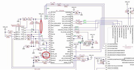

  • Hi, I have the same problem: PHY doesn't answer to any register read on RMII (I tried all the PHY addresses 0..31).
    Own design: DP83848 + Microchip PIC32 with internal MAC.
    (Don't care red circles..)
    Checklist until now:  X1 50MHz,
    power 3.3V on AVDD33+2xIOVDD33, grounded 2xAGND+2xIOGND+DGND,
    RX_DV/MII_MODE 2K2 pulled up for RMII mode, COL/PHYAD0 floating,
    The PFBIN1/2/OUT are tied together, ohm-checked on pins, 10uF+3x100n's are
    okay, still there is 720mV on them instead of 1.8V you mentioned.
    I checked MDIO on scope: START (01), RD (10), PHY_ADDRESS (0..31 all tried),
    REG_ADDRESS (00000)...then MDIOline goes tristate and pulls up, no answer
    from 83848. Is there any hint what caused this?  Can PFB problem set back RMII reading?
  • The PFBOUT pin should provide a 1.8V output.  That 1.8V powers on-chip circuitry via the PFBIN1 and PFBIN2 pins.  If you are not seeing 1.8V on these pins, then that should be the primary focus of debug.  Until this 1.8V supply is operating correctly, the device will not operate correctly.
    Since you have confirmed the connections for the PFB pins, I would suggest that you examine the RBIAS resistor.  This resistor sets the primary internal bias for the device.  There are two measurements that I would recommend:
    1. With the board powered up, measure the voltage across the RBIAS resistor.  The voltage should measure approximately 1.2V.
    2. With the board powered down, measure the resistance of the RBIAS resistor.  The resistance should be 4.87 kOhm +/- 1%.
    Based on the results that you are seeing, I suspect that there may have been a stuff error on the RBIAS resistor.  Most likely, the value of the RBIAS resistor is too high.  Perhaps it is 487 kOhms instead of 4.87 kOhms or something along those lines?
    Patrick
  • Thanks, Patrick,
    sorry for the false alarm..it was a simple soldering problem. Don't know where exactly,
    but manual re-flowing made it work. Previously I measured PFB voltage by a hand DVM,
    I touched the heel of the pins by a pointed probe, and maybe this pressed the pin to the PCB.
    Strange, because I measured the fairly constant 720..730mV on each pins.   I see you know
    a lot about the 83848: what are the "reserved" pins (20,21), is it important to pull them up
    through a 2K2 ?
  • Glad to hear that your problem is resolved.  Based on the symptoms you reported, a stuff error or a soldering issue would have seemed to be the most likely cause.
    The reserved pins (20, 21) connect to circuitry that is not used in normal operational mode.  It is important to pull these pins up to the 3.3V supply via a resistor.  Like many of our strap pins, we recommend a 2.2 kOhm resistor, but the exact value is not critical.  A resistor in the range of 1 - 5 kOhms should be sufficient.
    Patrick
