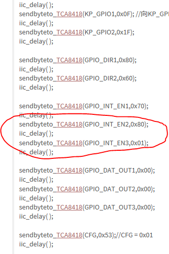

    It sounds like you are saying that sometimes after you have send 0x1F to INT_STAT(0x02) and then you go to read INT_STAT you sometime have something other than 0x00.
    After looking at your code it seems to me that you are enabling GPIO_INT_EN2 and GPIO_INT_EN3 bits but you never read them or clear them.
    It appears you are only reading GPIO_INT_STAT1, not STAT2 and STAT3.
    You need to read GPIO_INT_STAT2 and GPIO_INT_STAT3 and clear (write FF to each register, 0x12 and 0x13) them, assuming their was an event that triggers that INT.
