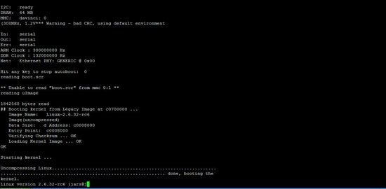

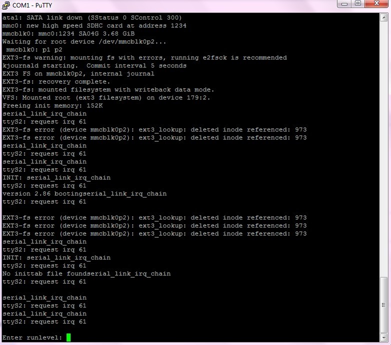

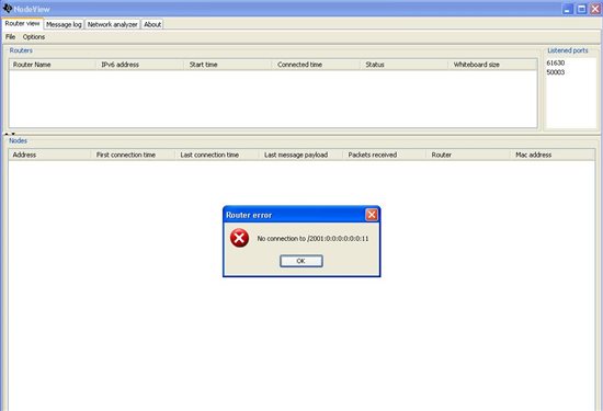

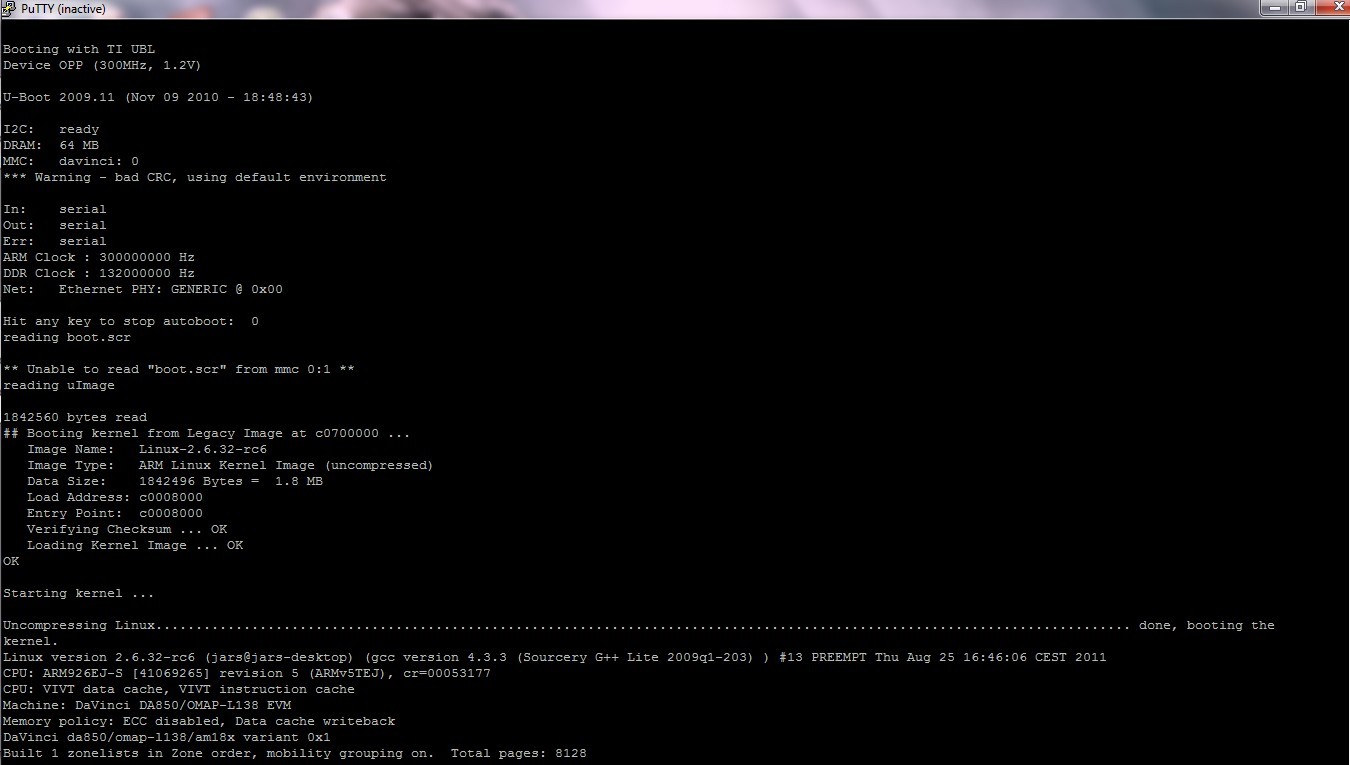

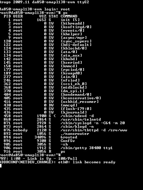

I purchased CC-6LOWPAN-DK-868 last week. I followed the steps according to CC-6LOWPAN-DK-868 Quick Start Guide and User's Guide. but in step 4(as mention in Quick start Guide) I can't see ipv6 router and only see the error message "No connection to /2001:0:0:0:0:0:11".

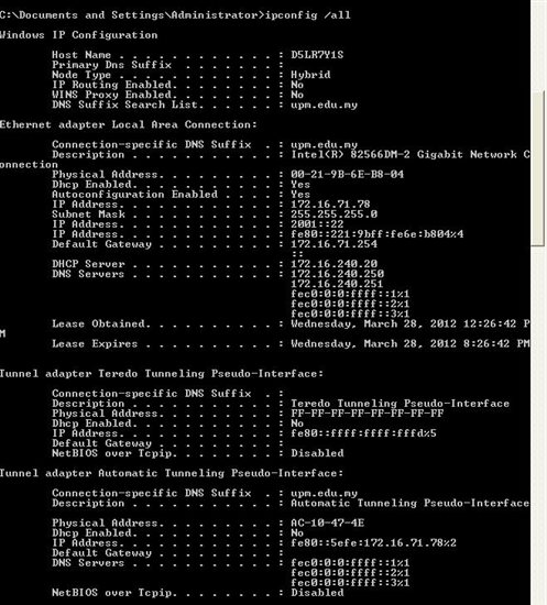

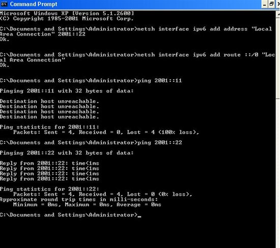

I can see "PHY: 1:00 - Link is Up - 100/Full" using hyperterminal and also found address 2001::22 under "Local Area Connection" when I use Dos command "netsh interface ipv6 show address".
Here my machine is installed Window 7 Enterprise.
Anybody, can you help me why my machine can't get ethernet connection with edge router.
