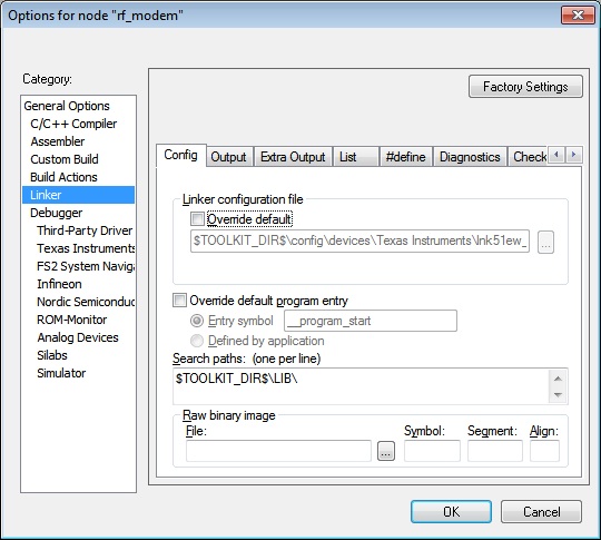

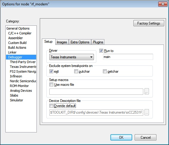

  • Have you tried the new USB CDC driver (or really signed .inf files) that we now distribute with SmartRF Studio? Look for ccxxxx_usb_cdc.* in C:\Program Files (x86)\Texas Instruments\SmartRF Tools\drivers\vcp.
    Uninstall whatever driver you have for the dongle (make sure they are all uninstalled by displaying hidden devices in the device manager) and point to the location mentioned above when installing the driver.
    Also make sure you use the correct project setting when building the USB example. The current version of the examples is quite old, so newer versions of IAR might mess up the project options when converting the old project files. Here's a couple of screenshots showing the project options I'm using with IAR EW8051 v8.20.2 when building the code from swrc088 rev C. With these modification, the project builds without errors or warnings and the USB device works as expected.
