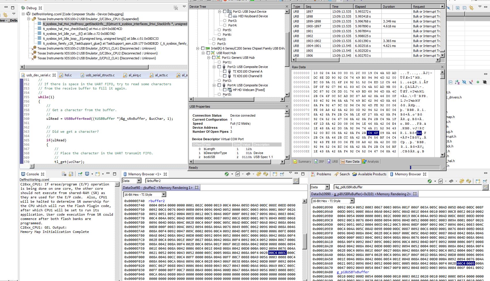

Delfino 28377D USB interrupts stop firing at seemingly random times.
Other Parts Discussed in Thread: CONTROLSUITE
The USB driver works great until I have to send large packets of data to the USB device I am developing.  It will get a random number of large packets successfully, and then halfway through one of the large packets, the interrupts will stop firing, and I cannot recover.  I need to get to the bottom of why this is happening and I am having a heck of a time.
I will attach a picture showing that data reception randomly stops.  On the top, you can see the full packet that our PC tool sent, the bottom left is our custom buffer for the data and on the right is the buffer supplied to the USB device when we set up the USB CDC object.   You can see that where it is highlighted is where it breaks down.  The disconnect seems to happen between the wire, and the USB device Rx buffer (g_pi8USBRxBuffer); data acquisition appears to stall because interrupts stopped.
  • Anyone have any ideas on why the Rx and TX interrupts stop firing? It seems that the whole USB stops working, as an unplug and re-plug of the cable doesn't re-enumerate the device.
  • I have found that rapidly sending packets of 65+ will cause the USB driver to hang and the Rx and Tx interrupts stop firing. If I limit my packets to 64 bytes or less and rapidly send those, the driver never hangs.

    Are you still getting SOF interrupts? Is the interrupt handler being triggered still?
  • After it seems to stall, I get zero interrupts. I put a break-point in "f28x_USB0DeviceIntHandler" which is the lowest level I can see. it never breaks there after it stalls.
  • It seems to be related to the amount of time in my interrupt handler. I rewrote my code to try and cut down on the processing done in the handler. This seems to have worked so far.

    We have identified the problem and are working on updating the USBLIB. For now, you can make a few changes in your project...
    There are three registers in the USB that are being used to generate USB interrupts to the PIE. USBIS, USBTXIS, USBRXIS. When any of these registers are set with values, the interrupt is flagged. All of these registers are cleared by reading the values from the registers.
    When a SOF (start of frame) packet comes into the USB, the USBIS register is set. When OUT or IN packets come into the USB, the RXIS and TXIS registers are set.
    Previous Fail Case:
    An OUT packet is sent to the USB and an RXIS interrupt is generated. In the interrupt handler, the USBIS is read first, then some more work is done before reading RXIS and TXIS. So, after USBIS is read and cleared, another SOF packet comes in before RXIS and TXIS are read and cleared. This causes the interrupt level to stay high. The SOF packet is never serviced properly and was causing a hang in the USB.
    Patch:
    Shortened the time between reading the USBIS and the RXIS/TXIS reads. Modify your project so USBIntStatusControl() in usb.c also gets the status RXIS/TXIS registers (like USBIntStatusEndpoint() does) and pass that status to a USB0IntHandlerInternal(), and use that value instead of calling USBIntStatusEndpoint() again. You may need to create your own functions with these modifications and call them from USB0DeviceIntHandler().
