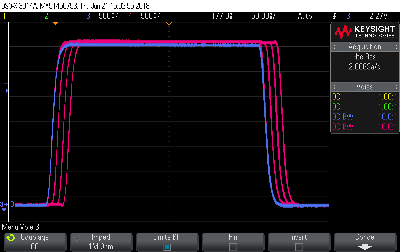

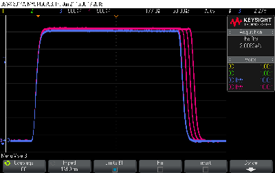

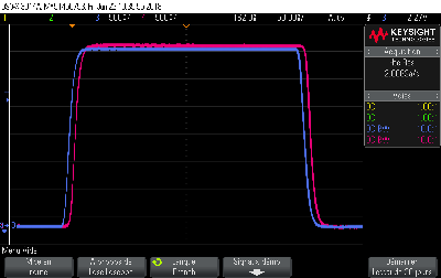

  • Hrishi,
    See attached oscilloscope captures of the behaviour of the HRPWM in up-down count mode with positioning on both edges. I still think you are wrong.
    I just ran the attached CCS project on a F28035 controlCard.
    EPWM1A (GPIO0) is the red signal (it has HRPWM).
    EPWM1B (GPIO1) is the blue signal (no HRPWM).
    Here is the result with FEP mode:
    Then the result in REP mode :
    And finally in BEP mode:
    These pictures make it pretty clear the HRPWM only delays the edges.
    You claim that the HRPWM can perform high-resolution duty control that is symmetric about the mid-point of the switching period. If it is truly the case then surely you will be able to provide an example CCS project which demonstrates this.HRPWM_UPDOWN_DUTY.zip

  • Hrishi,
    I came to the same conclusion. I was using ControlSuite version 126 but I noticed that a new example project was introduced in version 127.
    From what I understand there is a kind of "hidden" mechanism which allows the HRPWM to move the rising edge backwards by altering the effective value of CMPA?
    I did the following test:
    • EPWM1A (pink) has HRPWM and CMPAHR set to 1/3 TBCLK
    • EPWM1B (blue) uses the same CMPA but no HR
    • EPWM2A (green) has the same value in its own CMPA but no HR
    Here is the result with annotations explaining how I understand it:
    Can you confirm that this is more or less what's happening under the hood?
    Furthermore do you think it would be possible to improve the documentation in the future so that it is explained more clearly? I haven't seen anything about this mechanism in any datasheet or reference manual, even though I have read the documents for F28035 / F28075 / F28379 many times.
    Pierre
  • Pierre,
    I am glad this is sorted out. Thank you for checking this out quickly. Yes, I can confirm it is more or less the same way as you have described.
