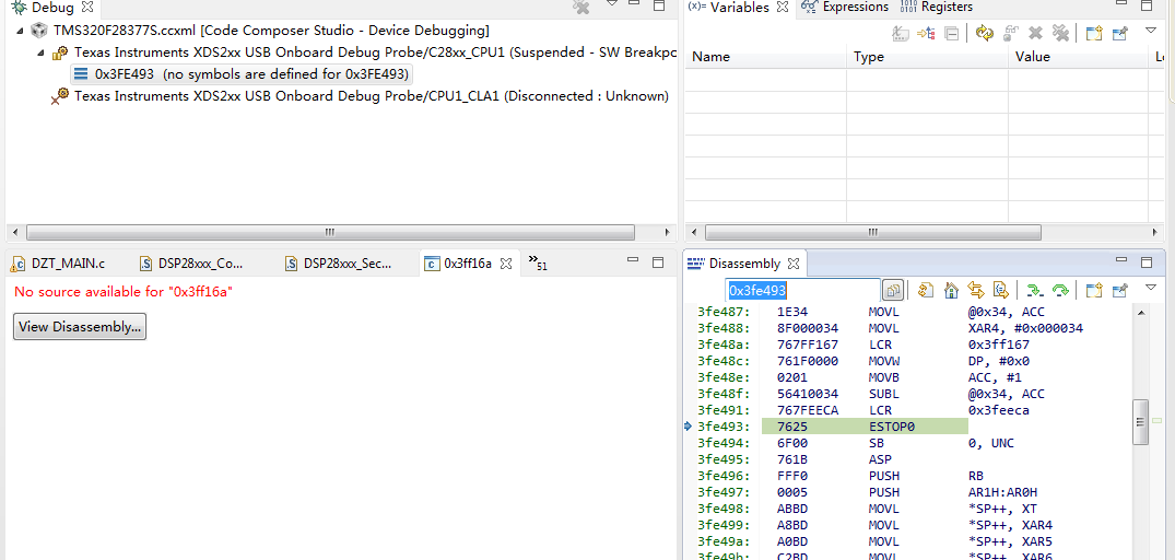

       I have a trouble recently when I develop a project using 28377. I try to  run my app in the sram load from flash, acourding to "SPRAAU8A" apprach, add the file "DSP28xxx_SectionCopy_nonBIOS.asm"  and change the file "F2837xS_CodeStartBranch.asm" instead of the "DSP28xxx_CodeStartBranch.asm". but afer build project and load, the CCS halt at 0x3fe493 before jump to main(). so can anyone help me?
     by the way, my app is run correctly when load to ram and load to flash that not use bootloader.

  • Hi Katta
           thanks for your reply, I have refered the 884720, the problem is not the same as mine.
          The first is My hardware, emulator and App work well, since my app runs correctly boot to RAM using "28377S_RAM_lnk.cmd".
         also my app runs correctly boot to flash using "2837xS_Generic_FLASH_lnk.cmd"  with certain sections copy to ram.
         but when I try to copy the entire app from flash to ram, after build and load, ccs halt at 0x3fe493, then press run buton, loop at 0x3fe493.
         seems jump to ITRAP interrupt and dead loop. I don't know why?
    Can you please tell me how many extra words were added with your change in the example for .TI.ramfunc?
    If the size exceeds the size of RAMLS0 i.e. 0x800, combine RAMs. For ex:-
    .TI.ramfunc : {} LOAD = FLASHD,
    RUN = RAMLS0 | RAMLS1 | RAMLS2 |RAMLS3,
    Modify it to
    RUN = RAMLS03,
    where RAMLS03 : origin = 0x008000, length = 0x002000
    Please try with this change.
