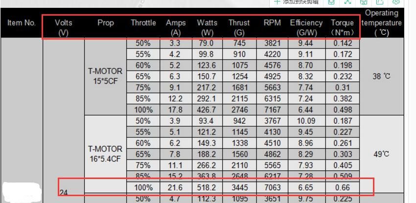

2. The above problem is mainly due to my application of InstaSPIN . my motor parameters as shown below:
and I just know the max DC bus current ,max Power(W) and the rated voltage of my motor.
I do not know the RMS and Peak wind current .

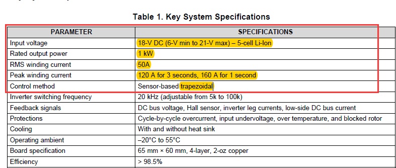

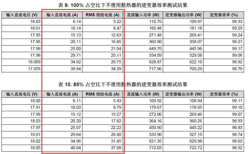

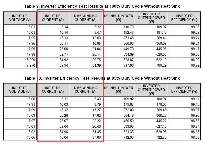

2.This  is a motor drive test parameter at TIdesign. Analyze the following parameters, the dc bus current is larger than the RMS winding current. Is this  true for all motors?
Now I just want to know how to design my current sampling circuit when I only know the motor power, voltage and bus current. and select the sampling resistance value?

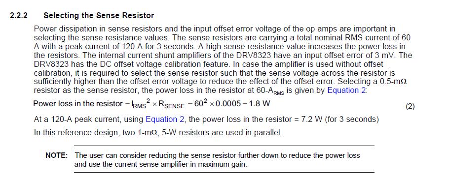

  • 1. The maximum current depends on MOSFET and h/w board, not related to input voltage. There is no formula between dc bus current and phase current, you can calculated the phase RMS current using the input power. You can select the shunt resistor based maximum power of motor, minimum input voltage. You need to select the power and resistance of shunt resistor according to both phase peak current and rms current.
    2. As talked above, to reserve some buffer, the peak current is about 3 times of maximum dc current to select the resistance of shunt resistance, the rms current is 1.5 times of maximum dc current to select the power of shunt resistor.

    2.the test data is from  TIDA-00774.
    Plesse explain why select the resistance(0.5mΩ) of shunt resistance?
    I am confused that  the dc current and the RMS current  is not match the 1.5 times in the test data ?
    because of the  trapzoidal control or FOC control?
    I think it is different .

  • There is no directly relation between dc input current and phase rms current of motor, the dc current depends the dc inout voltage and motor power. You can caculate the dc input current or phase rms current based on the input power or motor power.
