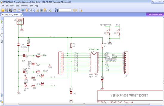

I am using TI launchpad. In the hardware connection of this launchpad(which is shown in TI,s website) the pin no 5 is connected with Vcc using 47k resistor and to GND using 100nF capacitor. But when I am programming the micro controller msp430g2553, the program is running correctly but the voltage at pin 5 is almost 0V. But according to the hardware connection this voltage should have been Vcc. Why this problem is occurring? the link from where i took the reference of hardware connection of msp430g2553 in launchpad is http://www.ti.com/product/msp430g2553. this is the snapshot of hardware connection

  • Hi Akhilesh,
    That schematic is for revision 1.4 of the launchpad. You've probably got revision 1.5 instead, which does not have an external pullup resistor on P1.3 (pin 5). Also note that the capacitor C24 is marked DNP (Do Not Populate).
    If you want to use pin 5 as an input you can enable the internal pullup resistor by configuring P1REN and P1OUT appropriately. See section 8.2.4 of the MSP430x2xx Family User's Guide for details.

    I'm not sure what's causing the problem you're getting on the breadboard, but just wanted to point out that the Rev.1.5 schematic is incorrect. I have a Rev.1.5 launchpad and R34 is not present. If you look at the row of SMT components running across the launchpad from the right of the J1 silkscreen label you can see the locations for R34 and C24. Both are unpopulated on my board. I've also verified that there is no connection between pin 5 and GND or VCC (when S2 is not depressed).
    Back to your problem, are you using the launchpad's emulation section to provide power and JTAG/SBW connection to your breadboard for programming? If so, how is the launchpad connected to the breadboard at the moment you test the pin 5 voltage?
