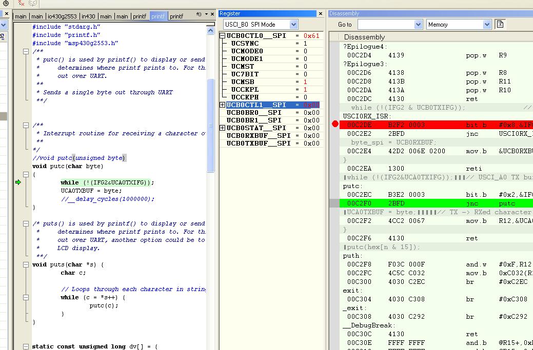

  • I am having an issue with the UART now which I think is related to the SPI configuration.  At the very beginning of main after intializing clocks and the UART I have a line of code:
    printf("test");
    Only the first "t" and "e" are sent to the terminal.  After this it gets stuck in the printf function at this point:
    void putc(char byte)
        while (!(IFG2&UCA0TXIFG));            // USCI_A0 TX buffer ready?
        UCA0TXBUF = byte;                    // TX -> RXed character
        //__delay_cycles(1000000);
    It's interesting that it prints the first two characters but gets stuck in the printf function after that.
    I'm thinking this line:
    needs to be changed to take into account the SPI settings.  Anybody have any idea why it is doing this?
