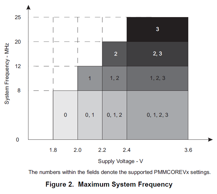

In datasheet it is written that MSP430F6779 can work at maximum 8Mhz if Supply Voltage is 1.8V.
Above limitation is for MCLK according to the device datasheet.
My question is that if DCO output has similar limitation.
For example
VDD = 1.8V
fDCO = 64 Mhz (suppose it is adjusted to generate this frequency using FLL)
And finally use DIVM to divide fDCO frequency to get final MCLK
Set DIVM = 8
So final fMCLK = fDCO/8 = 8Mhz.
Well, final MCLK is in the range. What do you think that is safe enough? Or there is another limitation for DCO output for 1.8V VDD?

    However please notice that the FLL of the UCS system produce jitter by changing the frequency above and below the target FLL frequency (you can also search for similar topic in this forum - a lot of detailed exaplanation from Jens-Michale Gross). This means that if you use 8 MHz, the FLL will toggle between 8+x and 8-x MHz, and the first one basically violate the spec.
    I would recommend to either use lower frequency (e.g. 6MHz) or use higher supply and PMMCOREV value.

    all the cases if you need to run MSP at 20Mhz or above (MCLK) you have to use PMMCOREV = 3. Default PMMCOREV which is 0 will not work even for your case.

    However, in this particular case, using DOCODIV with a prescaler of 8, or DIVM=8, will reduce the 'overshoot' to 8MHz+-(x/8) (=1.5% worst case). So considering the safety margin, it is very likely that it will work. Sure, not 100%, but 99.999 I guess.  Especially, as the limitt considers the full operating range.
    But as you said, to be sure, a higher core voltage setting or a lower frequency (but 6MHz is really much of a safety margin then) is of course the the way to go.

    I have another question regarding to PMMCOREV setting.
    In my application, I have two power domains first is 3.3V and other is 1.8V. I mean that MSP sometimes will be powered with 1.8V and sometimes with 3.3V.
    If MSP is powered with 3.3V, I will set MCLK to 16Mhz because I need more processing power in this mode.
    If MSP is powered with 1.8V, I will set MCLK to 8Mhz because no processing power required in this mode.
    And switching between these two modes should be fast.
    OK, MCLK frequency switching is easy and fast, I don't have any problem with it.
    But I have problem with PMMCOREV setting.
    In 16Mhz and 3.3V mode, I will set PMMCOREV to 2 this is OK.
    But should I set back PMMCOREV to 0 for 8Mhz and 1.8V mode?
    What if I keep PMMCOREV as 2 and just reduce frequency to 8Mhz at 1.8V?
    Any side effect other than consuming more power?

    i think you need to switch back to PMMCOREVx=0 if the supply drops from 3.3V to 1.8V. The reason is that in the datasheet - http://www.ti.com/lit/ds/symlink/msp430f6779.pdf - section "Recommended Operating Conditions" - page 57, it is mentioned that you need at least 2.2V Vcc supply to set PMMCOREVx=2.
