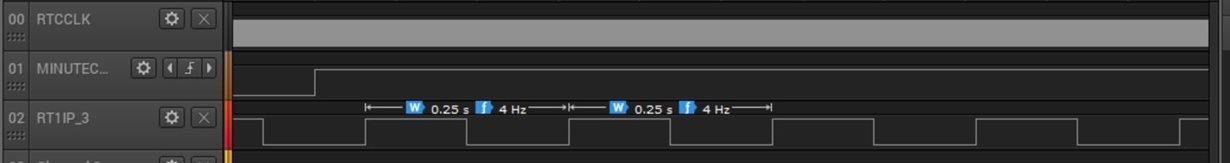

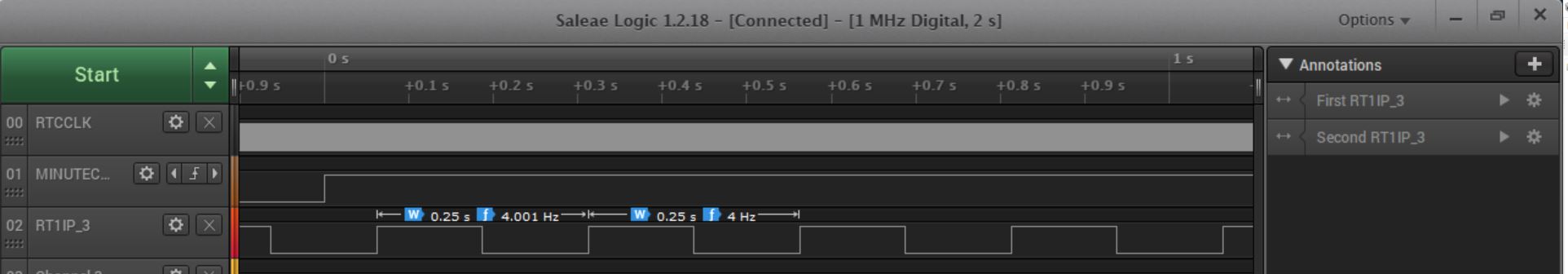

       The correction happens once every quarter second until the programmed ppm error is compensated.  I created a piece of example code which would generate an interrupt every 60 seconds as well as every quarter second to show how each quarter second was increased or decreased until the ppm number was reached.  I am not exactly clear on how the 512 Hz signal varies in that 250ms window but I think it is changing appropriately.
    No correction.
    +1ppm
    -2ppm
    I have attached the code.

    thank you for testing. I just watched the 512Hz and expected a reaction to the calibration value.
    Now i'll try how much the clock drifts away after calibration and then give a feedback.
    Thomas
    it seems to be working. The frequency at Port RTCCLK does not change, buit the correction of the RTC works. After 72h the error is around 1ppm/24h which might be a result of changes in temperature.
    Thank you for your help
