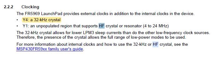

I have a MSP-EXP430FR5969. It has a Y1 for users to weld a high-frequency oscillator. According to the user guides, it says" The HFXT high-frequency oscillator can be used with standard crystals or resonators in the 4 MHz to 24 MHz range." I had a problem. I don't know what kind of oscillator can be used to this EVM. Would you please recommend some oscillators suitable for this one to use ? Would you please send me the model or product link. Thanks :)

The BOM ("Download Hardware Design Files" on the Product page) suggests the ECS-40-20-1X, Digikey part X971-ND:
https://www.digikey.com/products/en?keywords=x971-nd
This is a 4MHz crystal (in kind of a tall package). There are probably HC-49 variants in different speeds (and heights).
/cfs-file/__key/communityserver-discussions-components-files/166/MSP_2D00_EXP430FR5969_2D00_bom.xls
If fitting Y1 crystal, then C3 and C4 should also be fitted. The BOM attached by Bruce has the recommended parts for C3 and C4 to match the 4 MHz Y1 crystal.Bruce McKenney47378 said:The BOM ("Download Hardware Design Files" on the Product page) suggests the ECS-40-20-1X, Digikey part X971-ND
If I have a Y1 crystal which is not 4MHz, then how to choose C3 and C4 fitted Y1 ?
And the capacitance doesn't depend on the speed, so if you choose a "20pF" crystal (same as the ECS-40-20-1X) at a different speed you can use the same capacitors.

Alternatively, you can choose one of the (maybe 15) crystal speeds that DigiKey lists in that product line, all of which appear to be 20pF. Or use their product filters to find an HC-49 crystal at 20pF from someone else. Then you don't need the formula at all.

2)Besides,the datasheet says "Up to 16-MHz system clock and 8-MHz FRAM access". And another place says "Y1: an unpopulated region that supports HF crystal or resonator (4 to 24 MHz)" .
Does this mean the max frequency is 16MHz? Are there any other restrictions?

1) I see HC-49/U package and 20pF capacitance, so I expect any of those would work using the capacitors mentioned in the BOM.
2) The data sheet (SLAS704F) Table 5-5 says the MCU's HF oscillator can run at 24MHz, but footnote (3) says you can't exceed the max speed (MCLK usually) for the device. That max is given in Sec 5.3 as 16MHz. So in theory, you could use a 24MHz crystal but you'd have to divide it down to <= 16MHz. Since you only get integer dividers, that means with a 24MHz crystal the fastest you could run is 24/2=12MHz. (No, I'm not quite sure why someone would do that.) I recommend sticking with crystals <= 16MHz.
Don't forget to set NWAITS=1 (before switching the clock) if you pick something > 8MHz.
