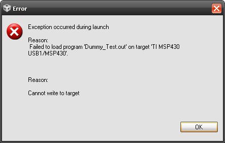

I'm having some difficulties programming and debugging the MSP430G2452 samples I got today. I'm using Code Composer Studio Core Edition Version: 4.2.1.00004 and Launchpad MSP-EXP430G2 Rev 1.4 trying to do so. Building works fine, but when i click on "Debug Launch" 4 out of 5 times I get the following error message:
MSP430: Trouble Writing Memory Block at 0xfffe on Page 0 of Length 0x2: Could not write device memory
Cannot write to target
When it works the chip get's programmed correctly, but running or stepping during a Debug session never works, I always get the error message:
MSP430: Can't Run Target CPU: Could not run device (to breakpoint)
Programming and debugging an MSP430G2231 works fine with the same Launchpad.
Does anybody have similar problems and know how to solve them?

  • Hi Markus,
    as already mentioned by old cow yellow you're not the only one who's having problems with the MSP430G2452 samples on the launchpad! But, you were the first one who's given details on the launchpad revision!
    I have some of them, took a Rev 1.4 (new out of the box!) and tried programming the G2452. As you, I was unable to program the device:
    MSP430: Trouble Writing Memory Block at 0xfa7c on Page 0 of Length 0x32: Could not write device memory
    I removed the sample from the Rev 1.4 launchpad and mounted it on my Rev. 1.3 ones (the one I've used so far). After clicking DEBUG in CCS the download (and the app) works like a charm!
    CONCLUSION:
    All you guys out there facing problems in programming your MSP430G2452 parts, pls check your launchpad revision (printed under MSP-EXP430G2).
    To the guys at TI: Pls tell us about the difference of Rev 1.3 and Rev 1.4 launchpads! The users manual still shows Rev 1.3 (http://focus.ti.com/lit/ug/slau318/slau318.pdf) and has no details on 1.4!

  • Hi Eric,
    sad to say: I'm not with you!
    Yes, your're right when saying 'ERASE MAIN MEMORY ONLY' causes an error. I've did some testing (on a REV1.4 boards) which always results in the errors shown below when'ERASE MAIN MEMORY ONLY' is selected:
    Selecting 'ERASE MAIN AND INFO MEMORY' gives you:
    So, still impossible to debug the MSP430G2452 on Rev1.4 launchpad!
    I've had a look at the DLL-Version I'm using (it's 2.4.7.1), (just to be shure) CCS 4.2.1.00004 (it's the Microcontroller Edition with GRACE installed) before I un-mounted the MSP430 from the Rev1.4 Launchpad and re-mounted it on my Rev1.3.
    Re-doing the same tests again resulted in the same error when selecting 'ERASE MAIN MEMORY ONLY' on the Rev1.3 too. Erasing main and info works without problems!
    CONCLUSION:
    REV1.4 will not allow debugging! REV1.3 does, but only if one selects 'ERASE MAIN AND INFO MEMORY'!
    Rgds
    aBUGSworstnightmare

  • I am having the same problem.   I am using a LaunchPad, rev 1.4.   And my CCS is 4.21.00004.  This is the message I see when trying to write to my MSP430G2452PW sample:
    I also see this error:
  • Both chips are OCDYRKKA / M430G2452.
  • Oops, here is that error.
    1122.CCSError.tiff

  • I have tried a fresh Windows XP Pro 32 bit  install with CCS, both updates, and IAR.  And.....
    CCS:
    IAR:
