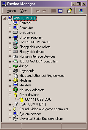

  • The driver for the CC1111 USB RF access point does not successfully install on my system. I tried manually installing by pointing Windows to the usb_cdc_driver_cc1111.inf file, and Windows tells me that it was unable to locate a driver for the device. If I manually run DPInst.exe, the Wizard's status indicates "Install failed (Unsigned)".
    My operating system is Windows 2000sp4.

    Would it be possible to post a picture of your device manager?
  • Brandon,
    Sure. The CC1111 USB CDC is not plugged into a hub.
    MCU Guru

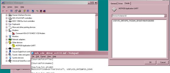

  • I have the same problem as MCU Guru.
    Using the CC1111EV ,the HID  demo works fine but when I try the CDC (rfmodem) demo the hardware wizard reports no driver found.
    I pointed it at usb_cdc_driver_cc1111.inf and checked the VID/PID (0451/16A6) in the inf file matched the VID/PID in the device, but still no luck.
    I'm running win2Ksp4.

  • Everyone please don't make the rather dim mistake I did.  There are two USB devices in the kit.  One is a debug probe, the other is an RF access point.  Make sure you have the right one inserted.  I was trying to run the demo using the debug probe - That won't work!  I'd hurriedly opened the package, read little, and failed to notice the RF probe tightly wrapped in an anti-static bag...  Sigh.
