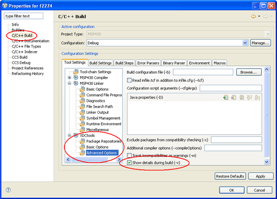

  • Below is my build log for your reference.  Looks like you are getting an error on a generated file that I have at:
    C:\workspace\MSP430_Grace\IDLE_Wake\Debug\configPkg\package\cfg\button_p430.c
    and builds fine
    >>configuring button.p430 from package/cfg/button_p430.cfg ...
    >>cl430 package/cfg/button_p430.c ...
    Do you see an xxx_p430.c file in that directory?
    I don't see a file called "Code" anywhere in the Workspace,  Sometimes the generated errors messages can be a little confusing.
