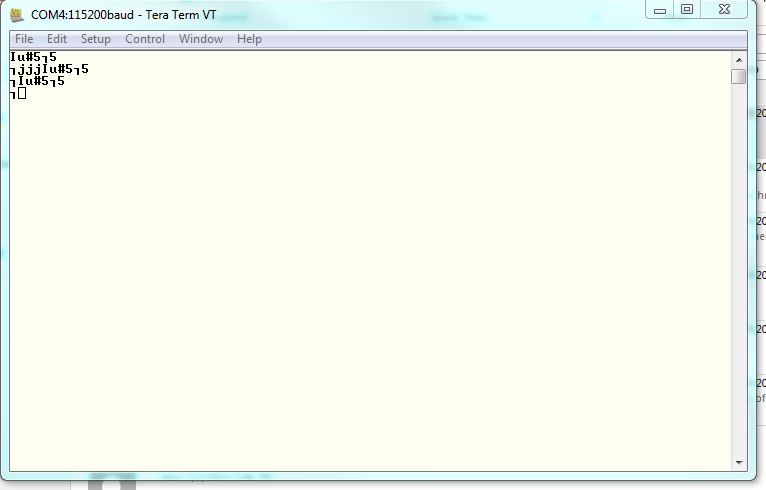

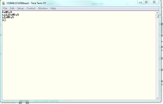

  • I know these are all 'simple' projects for a complex micro, but I'm at my wits end...  I have three Tiva (TM) C Series LaunchPads.  For the past two days, I have been trying to get something other than UART0 to work with Tera Term.
    I used the code above by magyarm (thank you!), to implement UART1 but reverted to PB0/PB1 as I am at least getting something out of it.  Once the header pins are hooked to my PC through a RS232 DB9 to USB, this is the best I can get out of the code:
    I'm using the GND pin on J2, and PB0 and PB1 on J1.  What am I missing?  I can upload my code, but it is identical to that posted above.
    Thank you.
