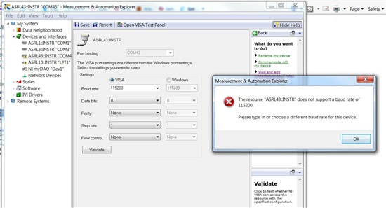

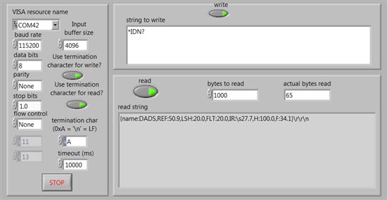

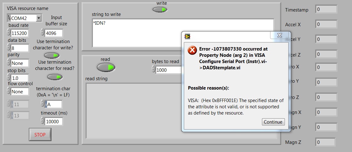

 I am trying to receive a text packets send from Tiva Launchpad, LM4F232H5QD Evaluation Board and MSP430 Launchpad using Labview VISA serial port.
With Labview example all works well with MSP430, but giving an error with others, so my guess is it is a Stellaris Virtual Serial Port driver problem. My PC is Win7 64-bit. When connecting the microcontroller output through FTDI cable everything works fine as well.
  • My apologies, wrong picture. See the one below.

    It sounds like LabView doesn't like something about the serial port definition. It might be trying to set an OS port attribute that isn't supported/etc.
    I do see a similar discussion on the NI community forums. If this is not your post, you might find the discussion useful for debugging. Particularly the suggestion at the end of the thread to remove VISA Configure Serial Port attributes to test if one of them is causing the problem.

    I went ahead and pulled the LV evaluation down and believe I got enough installed to replicate what you are seeing. I think this is the result of the Tiva Launchpad's use of Microsoft's USBSER.SYS driver to provide the virtual serial port through a basic implementation of the Communication Device Class' Abstract Control Model (CDC ACM).
    Based on NI's documentation here, it looks like LabView uses SetCommState() and then verifies the baud rate with GetCommState(). From a small amount of research into these APIs, it looks like GetCommState() will always return the default baud rate in this case as this is a "virtual" COM port. This likely explains why 9600 baud works as LV is able to verify it with this API Set/Get exchange.
    Launchpads that use FTDI chips for this feature are able to make use of the FTDI driver stack which includes a more full featured 'faked' COM port and don't use the in-box USBSER.SYS driver. I believe this is why they don't exhibit this problem.
    I'm not savvy enough with LV to determine if one can wire things up to ignore the error from the baud rate change. There might also be a way to force LV to always use the driver port settings (as setup in the device manager's "port settings").  One of those two options might get you past the issue.
  • Hi Mitch,
    Thanks, but I have no luck so far.
    The second option - setting default baud rate to 115200 doesn't work (see attached picture).
    Don't know how to try the first option, can you be more specific.
    You assume that SetCommState() puts just single USB Request (Set_Line_Coding), but it’s wrong.
    usbser.sys (Windows in-box CDC-ACM driver) puts this Request sequence for single SetCommState() call.
    - GET_LINE_CODING
    - GET_LINE_CODING
    - SET_LINE_CODING
    - GET_LINE_CODING
    - SET_CONTROL_LINE_STATE(0x02) - RTS:1, DTR:0
    - SET_LINE_CODING
    - GET_LINE_CODING
    And then, SetCommState() could always fail, if the device wouldn’t return the new line coding (ie. baudrate, data bits, parity, stop bits), set by SET_LINE_CODING.
    The solution of this problem is found in \qs-logger\usbserial.c
    - GetLineCoding() returns the same parameter set by SetLineCoding

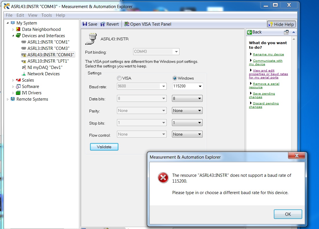

    Does it give you the same message if you tell it to use the Windows settings (the other radio button)?

    Thanks for the information. I had not actually made that assumption because I have seen the list of CDC events that get generated for these calls. But it does look like the line coding tracking is the cause of this LV issue. The ICDI firmware does handle these events but it looks like it might be trying to be a bit too clever.
    I'm going to start the process of getting a respin for this firmware. This will also require a new release of LMFlashProgrammer to deliver the update to the boards.
  • Hi Mitch,
    Yes, there is the same error message when using Windows setting.

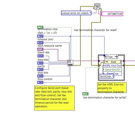

    Have the answer from NI
    "Ive heard back from our R&D. And the response as below;
    This problem seems to be something that TI is looking to fix with future firmware updates. It seems to be rooted at the fact that our functions do an actual check of the baud rate set and will not proceed unless the actual baud rate is what we set it to. TI mentions that because there is a certain error margin, the baud rate is not actually set to what the user commands.
    -This is a known issue for a large number of third party devices when setting baud rates. (CAR #182027). There is no current known workaround through VISA and it does not look like we will be fixing the issue before the next release for 14.0 since the CAR has been deferred.
    One thing we COULD try is to handle the error and proceed with the program having ignored the error. You can look at ways to do this by the following
    KB:
    How Do I Ignore a Specific Error in LabVIEW?
    http://digital.ni.com/public.nsf/allkb/BF72229C53F7633386256EDD0069331B
    Let's attempt to ignore the error and just trust the driver to be able to communicate at the incorrect baud rate. Please ensure the customer knows that this error is being thrown because of VISA's double checking of the actual baud rate. This makes sure we are communicating at the baud rate we told it to. If the instruments has a certain error margin which VISA does not tolerate, it is unfortunate, but ensures robustness of the application."
    and this is funny
    "Please let us know how else we can assist."
  • unable to attached the vi, but still doesn't work

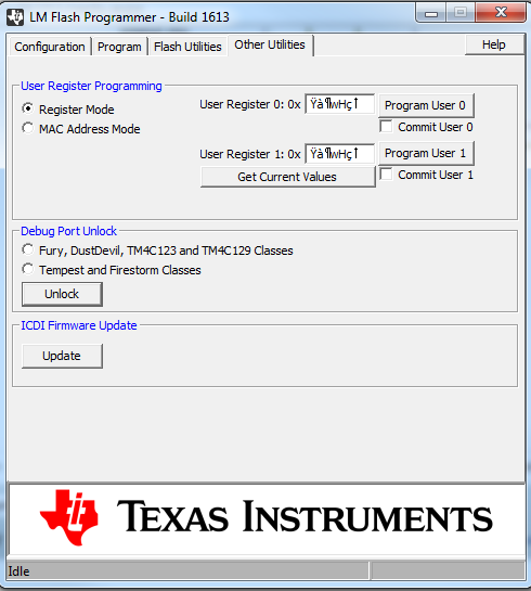

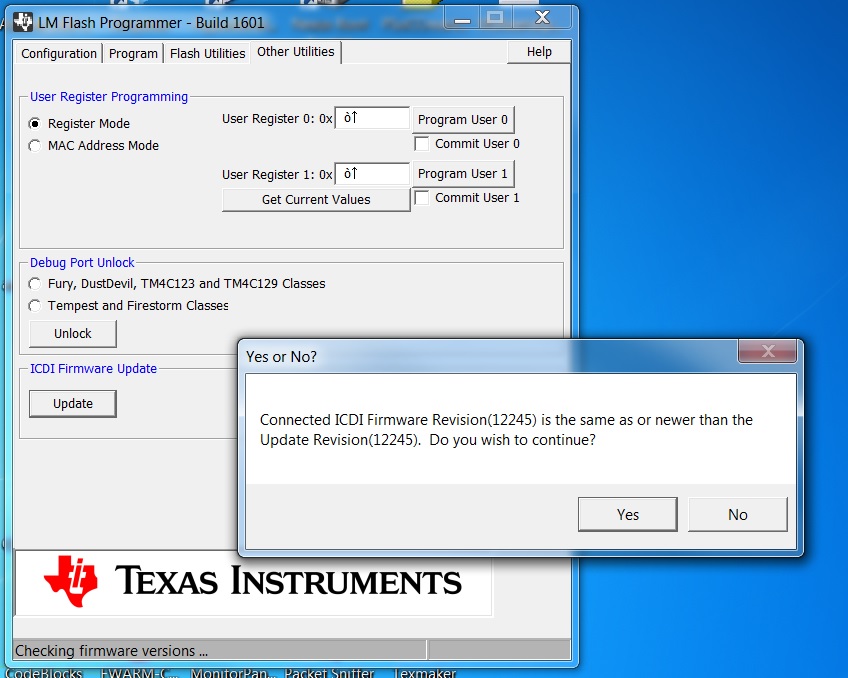

  • Hi Jan,
    There is updated firmware available which should fix this problem by always returning the baud requested (if it was within a valid range) rather then the actual baud. You can update the ICDI firmware on the Launchpad boards with LMFlash Programmer.  That option is found on the "Other Utilities" tab. You will need to have the Launchpad connected via USB to the host machine with the DEBUG port.
    I apologize this took so long to get posted and for the delay and notifying you in this thread.

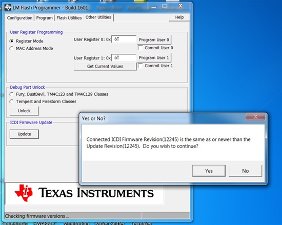

    Thanks, but can you give me an updated link to LMFlash Programmer?
    as the one in your latest post goes into version 1601 and does nothing.
    Jan
  • Hi Jan,
    I'll let the web team know that link is till pointing to v1601.
    You should be able to get v1613 from this link.
  • Hi Mitch,
    I am so glad and relieved, that I can press the green "Yes" button and accept the resolution of the problem
    Thanks very much to you and everyone else involved. Much appreciate it.
