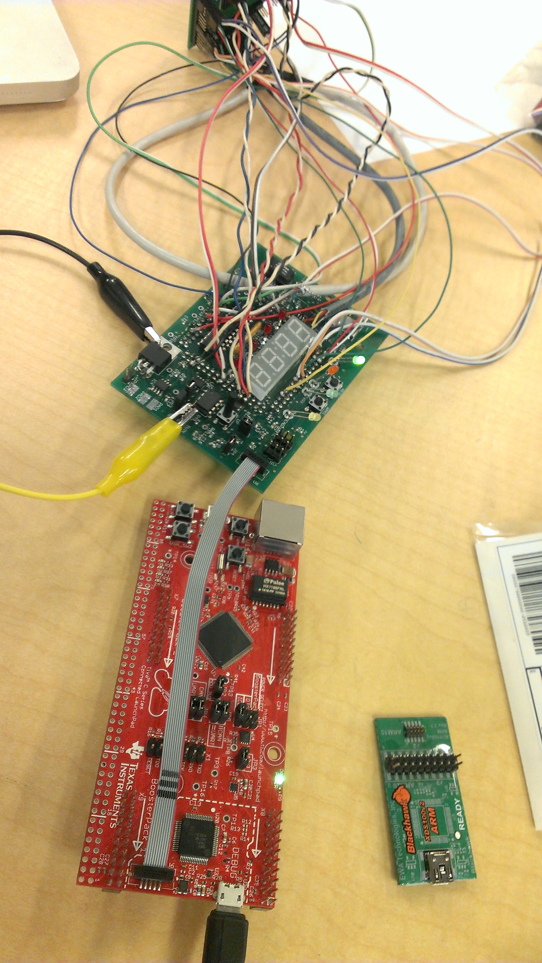

  • The device is a TM4C1294NCPDT, however I'm not really sure what the VCO setting is doing to the device. I copied this code from an example and it was necessary to have these clock settings to have the ADC produce correct results on the TM4C connected Launch Pad.
  • Hello Justin
    What is the crystal frequency on the custom board?
    Amit
  • Also, the main crystal connected is a NX3225GA-25.000M-STD-CRG-2 (25Mhz), which we tried to match up to the Launch Pad's crystal. However due to a PCB printing error we had to externally wire the controller to our PCB resulting in the crystal being a relatively far distance away from the controller.
  • Hello Justin,
    I am almost sure that the wiring of the crystal is the cause. However to get around the immediate issue, you would have to connect a LaunchPad's JTAG to the custom board JTAG to run the unlock sequence. If it is TM4c129 LaunchPad, then remove the resistors for JTAG and instead use the headers to bypass the JTAG to the custom board along with the LMFlashProgrammer.
    Attached picture will show how. Please do connect the GND of the LaunchPad to the custom board.
    Amit
  • OK we are going to remove resistors R6, R7, R8, R10, R11, R15 and R16 as well as R40 to turn the ICDI into an outbound JTAG interface correct? And we will be able to restore the ICDI to debugging the launch pad by restoring jumpers across the terminals in X1, just to confirm.
    Will the unlock feature erase the existing program on the controller and restore it to an empty state? I thought the unlock feature of LMProgrammer would only restore the original state of the JTAG pins if they were reassigned..
  • Hello Justin,
    Yes, that is correct. It will erase everything including EEPROM, user committed registers and flash.
    Amit
  • I've completed the removing of the resistors, and I have connected pin1->pin1 (in order to do that the red wire on the ribbon starts on our connectors VDD, then goes across the length of the launch pad and connects to U6 on the launch pad) the configuration looks awkward but electrically it makes sense.
    I've setup LMprogrammer to the TM4C1294XL Launchpad Quick Set on the first tab, then pressed unlock under Debug Port Unlock.
    It gives a warning about register erase, then prompts to assert and hold reset, then release reset, then power cycle the board, all of which I followed the directions. I then went to Flash Utilities and pressed "Erase" on the Erase Entire Flash option and receive the error message "**ERROR** Unable to initialize the target - 0!"
  • Hello Justin,
    Do not take it from U6 but from the newly installed headers which I have shown on the previous image and marked,
    Amit
  • Hi Amit,
    We have attempted to connect those pins to the custom board as indicated but our results didn't change. We have sent our board for reprint and, since that has been submitted, any errors in JTAG can no longer be corrected. We will hope and pray that our JTAG circuit is setup correctly and that shortening the distance between the crystal and the controller resolves the problem. If we have the same problem I will proceed to post on this thread, but it won't be until Friday or next week, fingers crossed :) Thank you for all your help.
