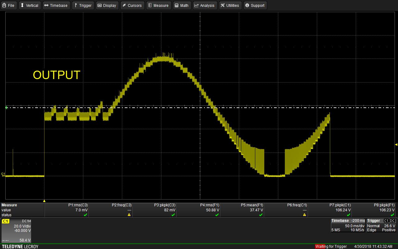

Good morning.
I'm Dae Young Lee in Microsystems Laboratory of  Myongji University(from south korea).
We are writing to you for advice on the problems faced in using the T.I.'s DRV2700EVM-HV500 (hereinafter 'evaluation kit') products.
The goal is to output signals of various types (sine wave, square wave, DC) using the evaluation kit.
It was possible to output various types of signals by using the evaluation tool of the evaluation kit (Piezo Control Console).
However, the noise is too severe to function properly.
(At the time of signal output, the setting screen of the programming tool and the shape and information of the output signal are attached to the file.)
Please check if the output information of the evaluation kit belongs to the normal category through the output signal of the attached file.
If this is a normal category, please advise how to solve the problem you are experiencing (serious noise).

  • Hi Dae,
    What size load are you using on the output? Also how clean is the input signal?
    There will be some noise due to the hysteretic boost architecture, but it shouldn't be as bad as the attached images.

  • Hi Daeyoung,
    The DRV2700 is designed to drive capacitive loads. Please try connecting a capacitor across the output and see if the output signal is less noisy.

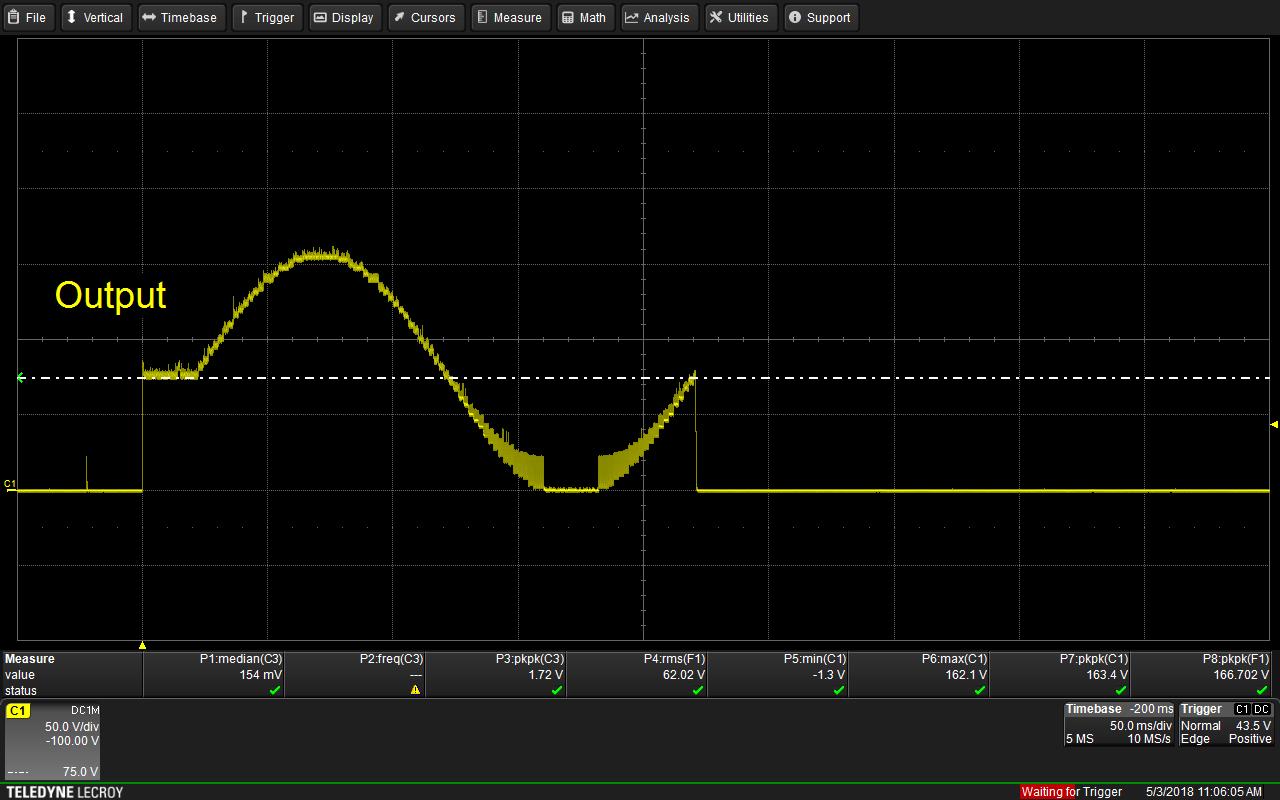

  • Hi Daeyoung,
    If you look at the note in section 9.2.5 of the datasheet, it states higher load capacitance will reduce the ripple. In order to reduce noise in this type of design, you need to optimize the flyback circuit for the specific output voltage and load capacitance. I ran some tests and got the below waveforms.. Even these waveforms are a little off. I am getting a new EVM to perform some additional tests.
    Also I noticed that your output is going negative. Is your scope AC coupled?
    10nF load
    880nF load

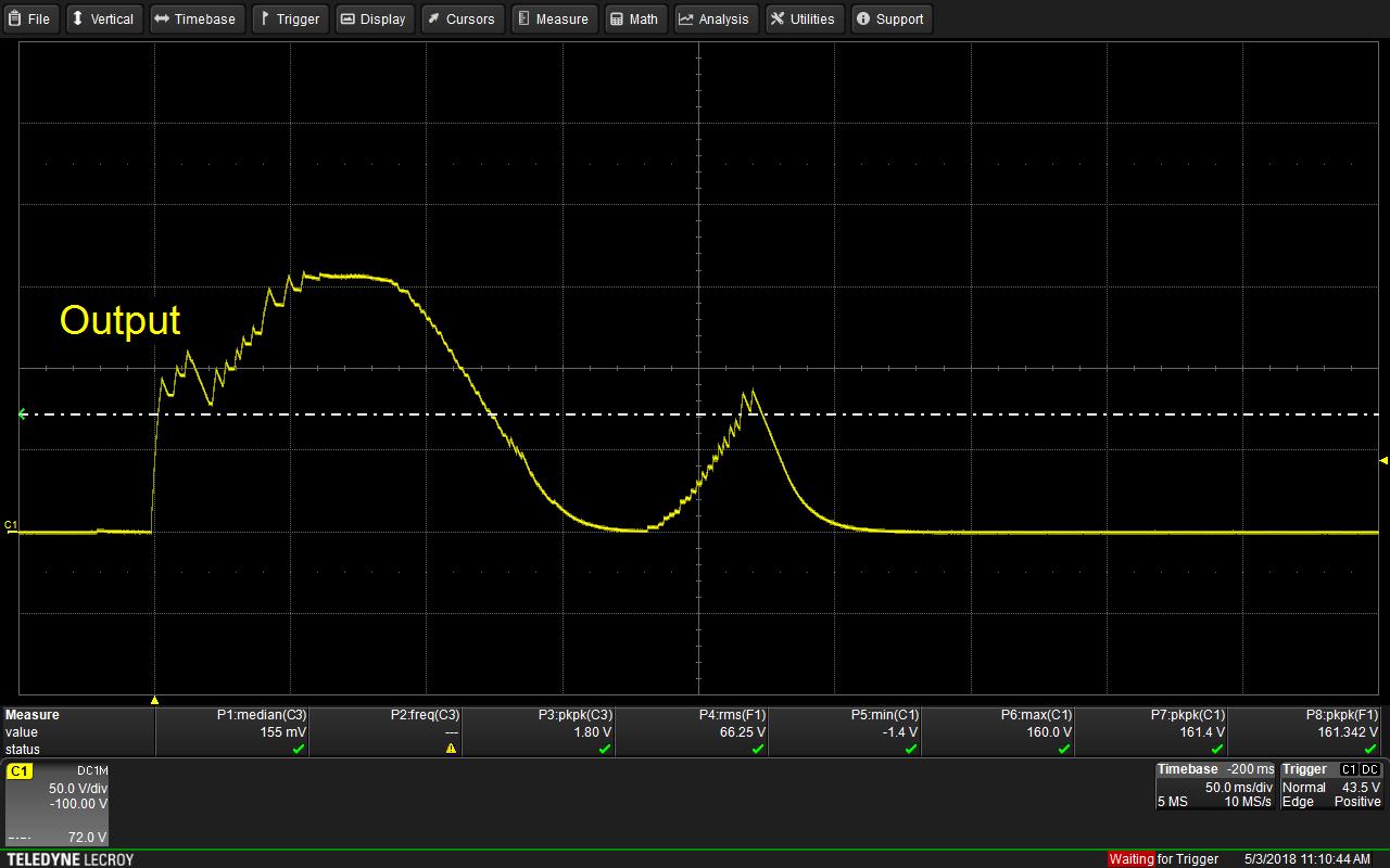

  • Hi Daeyoung,
    I tested again with a new EVM and I am able to reach the 158V output. The previous EVM must have been damaged. The results are similar. Add additional capacitance to reduce noise. However, there is still some significant noise in the sine wave. I suggest fine tuning the flyback configuration for your specific voltage needed and making a new board. We walk through a lot of the design information in the DRV2700 datasheet and DRV2700EVM-HV500 user guide.
    10nF load
    880nF load
    880nF load with analog input

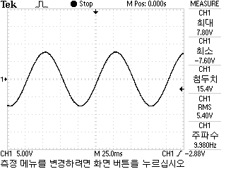

  • Hi Kelly,
    Thank you for your efforts.
    I am sorry to leave the message late.
    with 47 nF capacitor, setting voltage: 275 V, frequency: 10 Hz
    However, the signal has improved a lot, but the signal from the function generator has a different effect.
    Thank you,
    Daeyoung Lee.
  • Thank you for following up. I'm glad the output is looking better for you now.
  • Hi Kelly,
    The noise content has improved a lot because of you.
    The signal of this product is offset and output as shown in the picture.
    I want a normal sine wave, not an offset signal as shown in the picture.
    Let me know if you have a way.
    Thank you.
    Daeyoung Lee
  • Hi Daeyoung,
    Sorry, there is not a way to do this with a single driver. In order to get the differential output, you could try using two devices and hook each output up to opposite terminals of your load. Then setup the inputs to drive half sine waves 180 degrees out of phase.
  • Hi Kelly,
    Does that mean to combine the sine waveform of the current kit with the dc waveform of another kit to eliminate the offset?
    Is it possible to output the dc voltage in the opposite direction?
    I don't know if I understand it properly.
    Thank you,
    Daeyoung Lee
  • Hi Daeyoung,
    You will not be outputting voltage in the negative direction. If you connect your load differentially, then you can apply +500V to the positive terminal and +500V to the negative terminal. The load will see 1000V AC signal based around GND.
    If you are driving a single ended load with the other terminal connected o GND, then this is not possible.
