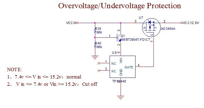

In my design, I use tps2400.
Recently. I process 50 pieces of new circuit board, there are 6 pieces is not normal due to tps2400.
when I  change the chip of tps2400,  the 6 pieces of  circuit board are back to normal.
it seams that the probability of bad tps2400 is relatively large, more than 10%.
