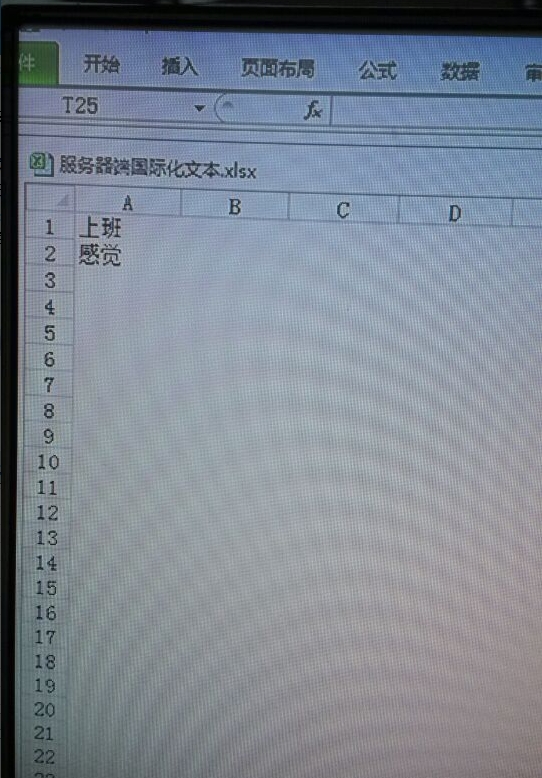

hi,all, My env: dm8168 and dvr rdk 4.0
My chains: vcap->vdis.
    when i cap the computer’s  desk signal to dis,i found that the character(for example the name of the desk image ) is not clear .for example, when I open a document(excel) , (1) The image (computer's desk signsl):
(2) the image (by dm8168):
campare to (1) , you can see no grid in excel--(2)the image(by dm8168). so, how can i fix that problem? thanks.
  • Create a data flow like
    Capture ->  ipcFramesOut (M3VPSS) ->  ipcFramesInHost (A8)
    and save the captured image and check if the grid is not seen in the captured image itself.
    This will help determine if issue is on the display or on the capture side

    Create a usecase with following links:
    and save the YUV frames .
    open the document ,the grid is not seen .( The above mentioned problems still exist )

  • Capture in YUV422I format will save the pixels received via Video Input Port to memory without any processing. If you see the issue at capture then the loss of quality is not due to  816x but due to external source. CHeck your external video decoder configuration.
    It is not possible to get frame before capture link.
  • Badri ,
          Following your suggestion, To check my external video decoder configuration.I have resolved this issue.
