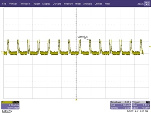

  • Hi Simon,
    Do you have a power switch on your VBUS rail, that's driven by the USBx_DRVVBUS processor pin? If your USB port is working in OTG mode you should see short voltage spikes on the VBUS rail (after the switch) without any external device attached.
  • ello Biser
    I see these spikes. I think ADP and SRP are working correctly.
    Best regards
    Simon
  • This is correct. The USB port is working in OTG mode. Where is the VBUS bulk capacitor placed? It should be after the power switch, close to the USB connector.
