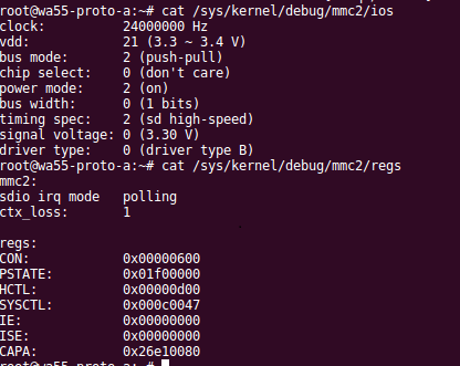

  • Are you using in-band interrupts or polling?
    Steve K.
  • Hi Steve,
    Could you give direction where/how to verify this? I.e. do you refer to the SDIO host controller?

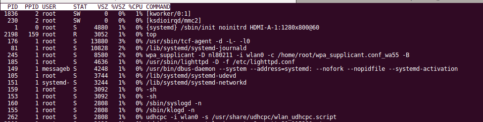

    In 1-bit mode u-blox module utilizes data line 1 (D1) as interrupt line as you can see in attached  picture.
    What we do observe in this context is that we have huge amount of intrerrupt from mmc2 in /proc/interrupts.
    kdsdioirqd/mmc2  when running top.We see in register overview sdio_irq_mode: polling

    and kdsdioirqd/mmc2  when running top.

  • the SDIO host is configured in polling mode. We have observed performance impact during that mode also for the am335x based reference board with our module. Currently we try to update the device tree to ahve inband interrupt activated. Unfortunately the Ti PinMux tool does not provide any indication when I do chose SDIO4-Bit

  • Thanks to Soeren Hoeckner thorough analysis we managed to have improved performance:
    Hello gents,
    well, I'm quite convinced the problem is originated with the SDIO host controller from the your MCU (am5708). The MMC3 slot is reporting the interrupt mode as polling (cat /sys/kernel/mmc2/regs). It has been observed also on the am335x a significant performance impact in that mode. Therefore the mmc host controller needs to remux the data_1 pin to a GPIO triggered interrupt, as specified in the SDIO specification. From our point of view does the module operate inside its specified parameters. By the way, this observed issue located on your SDIO host controller driver is affecting all SDIO devices.
    After an deep analysis of the omap_hsmmc.c host controller driver implementation, specific device-tree entries seem to be necessary to activate the inband interrupt handling [1]. The so called wake_irq is specified as second interrupt [2]. Without that the controller implementation falls back to polling [3]. Moreover the MCU capabilities are determined to identify whether to use the GPIO as wakeup source [4]. This matches your MCU (OMAP_HSMMC_SWAKEUP_MISSING) [5], if I'm not mistaken. It follows the look up for the muxing pins "default" and "idle", which needs to be defined in the device_tree as well or the driver falls back to polling [6,7].
     Below I have attached the MCU configuration that enabled the interrupt mode for the your SDIO host controller, implemented via omap-hsmmc.
    [1] http://elixir.free-electrons.com/linux/v4.4.32/source/drivers/mmc/host/omap_hsmmc.c#L2194
    [2] http://elixir.free-electrons.com/linux/v4.4.32/source/drivers/mmc/host/omap_hsmmc.c#L2069
    [3] http://elixir.free-electrons.com/linux/v4.4.32/source/drivers/mmc/host/omap_hsmmc.c#L1764
    [4] http://elixir.free-electrons.com/linux/v4.4.32/source/drivers/mmc/host/omap_hsmmc.c#L1777
    [5] http://elixir.free-electrons.com/linux/v4.4.32/source/drivers/mmc/host/omap_hsmmc.c#L1934
    [6] http://elixir.free-electrons.com/linux/v4.4.32/source/drivers/mmc/host/omap_hsmmc.c#L1783
    [7] http://elixir.free-electrons.com/linux/v4.4.32/source/drivers/mmc/host/omap_hsmmc.c#L1790
    attached device-tree necessities for interrupt mode:
