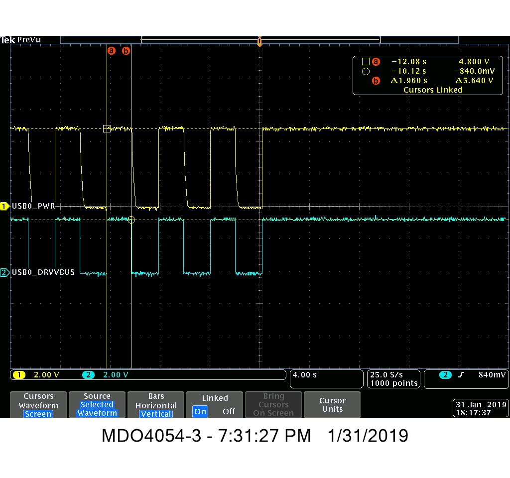

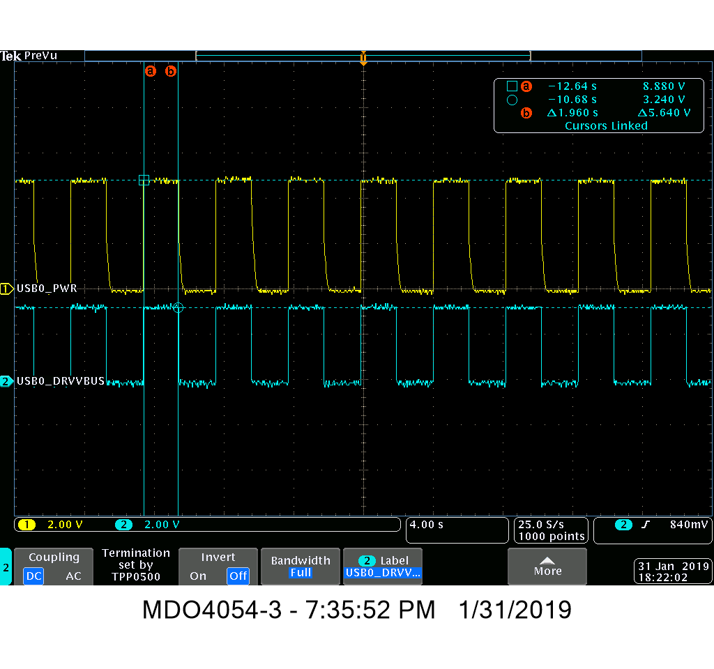

    Can you please first use a scope to probe the USB0_VBUS and USB0_DRVVBUS pin when plugging in the thumb drive? Based on this result I will give you the instructions how to get a kernel log.
  • The first capture is taken when a USB flash drive has got detected.
    Below capture is when USB flash drive hasnt got detected
  • Hi Fariya,
    Thanks for the captures, it shows the usb controller itself seems behaving correctly in both cases. Can you please add D+ line in the probing, assuming the failing thumb drive is a high-speed device? I'd like to see if there is any timing difference between USB0_VBUS and D+ pullup in both cases.
    If you cannot use 3 probes in the same time, you can remove probing USB0_DRVVBUS signal, since we know how it behaves along with USB0_VBUS signal.

  • Fariya,
    It seems the usb host waited for 10 seconds but still didn't detect the thumb drive.
    When you connect the thumb drive in the working case (the kernel without the first fix patch), did you notice that it takes a while the serial console shows the enumeration log or enumeration happens almost immediately after plug it in?
    Can you please apply the last debug patch to the working kernel (which is without the first fix patch) and provide the kernel log? I'd like to check the message timestamps between
    musb-hdrc musb-hdrc.0: drvvbus high
    musb-hdrc musb-hdrc.0: int 0x10
  • Hi Bin,
    Thanks so much ... This particular Sandisk drive doesn't take so much time (~3secs) to detect (without any patches). However after I apply latest patch + without first fix patch, it seems to be taking 20+ seconds to detect.. below are the logs:
    [ 4331.599724] musb-hdrc musb-hdrc.0: start session
    [ 4331.652355] musb-hdrc musb-hdrc.0: drvvbus high
    [ 4351.894962] musb-hdrc musb-hdrc.0: int 0x10
    [ 4352.149603] usb 1-1: new high-speed USB device number 3 using musb-hdrc
    [ 4352.328518] usb-storage 1-1:1.0: USB Mass Storage device detected
    [ 4352.341106] scsi host0: usb-storage 1-1:1.0
    [ 4353.361494] scsi 0:0:0:0: Direct-Access SanDisk Cruzer Blade 1.00 PQ: 0 ANSI: 6
    [ 4353.368754] sd 0:0:0:0: [sda] 124059648 512-byte logical blocks: (63.5 GB/59.2 GiB)
    [ 4353.374432] sd 0:0:0:0: [sda] Write Protect is off
    [ 4353.374522] sd 0:0:0:0: [sda] Mode Sense: 43 00 00 00
    [ 4353.375533] sd 0:0:0:0: [sda] Write cache: disabled, read cache: enabled, doesn't support DPO or FUA
    [ 4353.391548] sda: sda1
    [ 4353.399443] sd 0:0:0:0: [sda] Attached SCSI removable disk
    Fariya
  • Hi Fariya,
    Do you mean the Sandisk drive was detected about 3secs without any patch? Please do the same test again with the latest patch only but don't apply the last chunk in the patch (which changes the timer). So the only change is the 3 print statements. Sorry I should have asked this test yesterday.
    Basically don't apply this chunk:
    -                                 msecs_to_jiffies(wrp->poll_timeout));
    +                                 msecs_to_jiffies(10000));
  • Hi Bin Liu,
    Below are the logs as requested by you (3 secs from "start session" i.e when the device is plugged in to "new high speed USB device")
    1773.759860] musb-hdrc musb-hdrc.0: start session
    [ 1773.812495] musb-hdrc musb-hdrc.0: drvvbus high
    [ 1775.924915] musb-hdrc musb-hdrc.0: int 0x10
    [ 1776.209768] usb 1-1: new high-speed USB device number 2 using musb-hdrc
    [ 1776.389361] usb-storage 1-1:1.0: USB Mass Storage device detected
    [ 1776.405424] scsi host0: usb-storage 1-1:1.0
    [ 1777.441514] scsi 0:0:0:0: Direct-Access     SanDisk  Cruzer Blade     1.00 PQ: 0 ANSI: 6
    [ 1777.446101] sd 0:0:0:0: [sda] 124059648 512-byte logical blocks: (63.5 GB/59.2 GiB)
    [ 1777.448091] sd 0:0:0:0: [sda] Write Protect is off
    [ 1777.448166] sd 0:0:0:0: [sda] Mode Sense: 43 00 00 00
    [ 1777.448973] sd 0:0:0:0: [sda] Write cache: disabled, read cache: enabled, doesn't support DPO or FUA
    [ 1777.468559]  sda: sda1
    [ 1777.473201] sd 0:0:0:0: [sda] Attached SCSI removable disk
     Another iteration:
    1821.599851] musb-hdrc musb-hdrc.0: start session
    [ 1821.652488] musb-hdrc musb-hdrc.0: drvvbus high
    [ 1825.879840] musb-hdrc musb-hdrc.0: int 0x10
    [ 1826.139746] usb 1-1: new high-speed USB device number 2 using musb-hdrc
    [ 1826.317139] usb-storage 1-1:1.0: USB Mass Storage device detected
    [ 1826.328451] scsi host0: usb-storage 1-1:1.0
    [ 1827.361764] scsi 0:0:0:0: Direct-Access     SanDisk  Cruzer Blade     1.00 PQ: 0 ANSI: 6
    [ 1827.366732] sd 0:0:0:0: [sda] 124059648 512-byte logical blocks: (63.5 GB/59.2 GiB)
    [ 1827.368748] sd 0:0:0:0: [sda] Write Protect is off
    [ 1827.368822] sd 0:0:0:0: [sda] Mode Sense: 43 00 00 00
    [ 1827.373324] sd 0:0:0:0: [sda] Write cache: disabled, read cache: enabled, doesn't support DPO or FUA
    [ 1827.387482]  sda: sda1
    [ 1827.399143] sd 0:0:0:0: [sda] Attached SCSI removable disk
