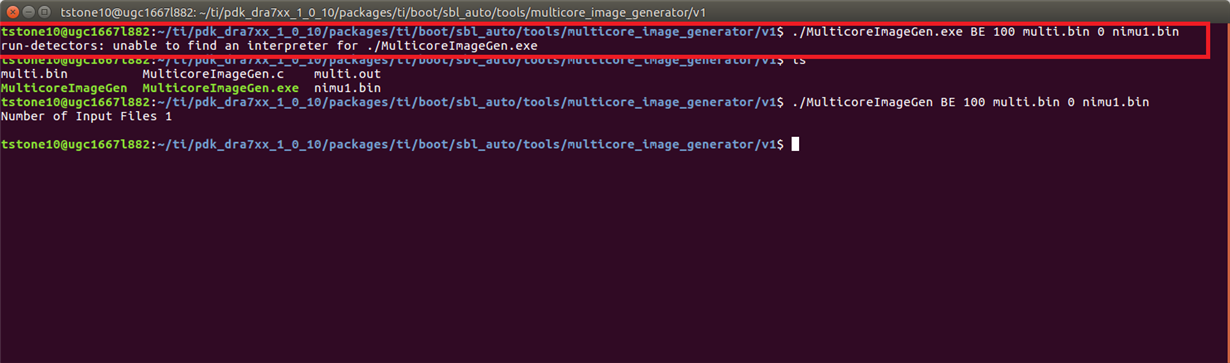

  • Swati,
    One more point. Multi core image generation command mentioned above is not correct.
    Can you check the SBL user guide and update the command.
    MulticoreImageGen.exe <ENDIAN> <Dev Id> <App out file> <Core Id 1> <RPRC in file for Core Id 1> [<Core Id n> <RPRC in file for Core Id n> ...]
    Rishabh
  • Hi Rishabh,
    Above command is not working . Please find the attached screenshot.
    so i have used the below command to generate the multicore out file
    ./MulticoreImageGen BE 101 Multi.out 0 nimu.bin
    MulticoreImageGen <BE> <Random number> <Multi.out> <0(as in the userguide for tda2xx ,please find the attached )> <nimu.bin>
    nimu.bin is generated from the following command - ./out2rprc.exe NIMU_BasicExample_evmDRA75x_armExampleproject.out nimu.bin
  • Hi Rishabh,
    In the above reply please let me know anything i have missed to generate the multicore app image.
    Swati
  • Swati,
    There is no <Random number> in multicore image gen command. It is actually device id.
    SBL throws a warning message if device id is not correct.
    Can you try the debug steps as mentioned in my first reply.
    Rishabh

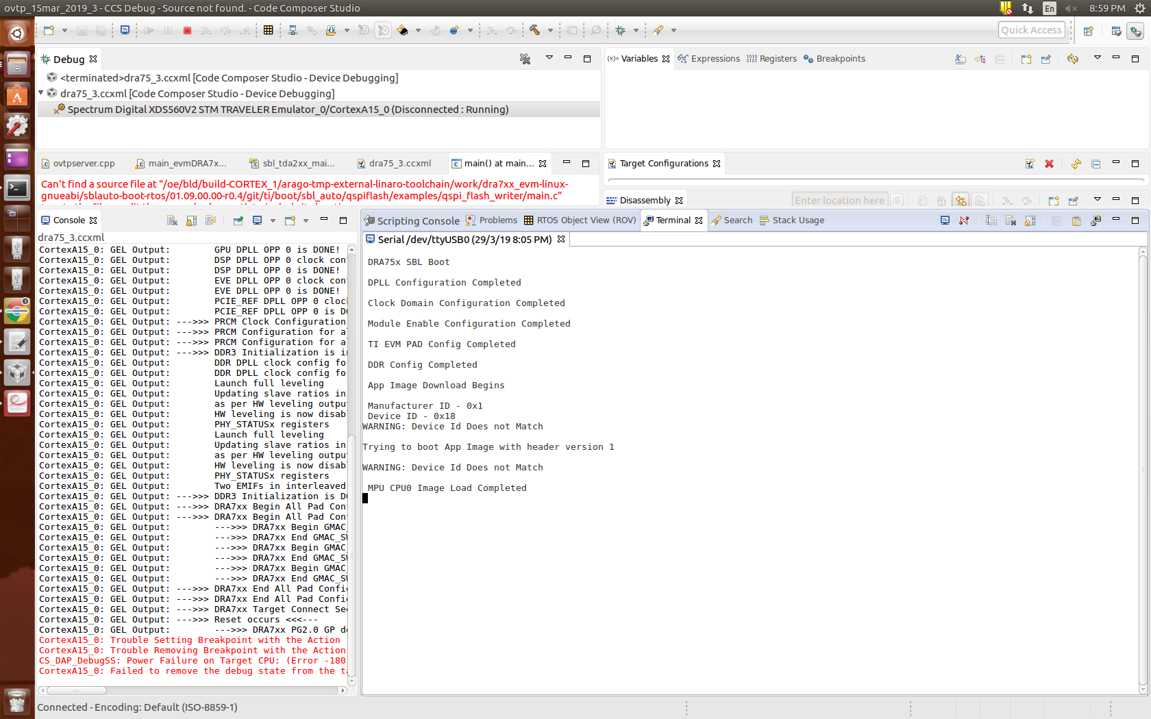

    4. Do a single step and then you will be able to find out the reason for A15 hang during/after app image load.
    Please find the below log in debug mode
    DRA75x SBL Boot
    DPLL Configuration Completed
    Clock Domain Configuration Completed
    Module Enable Configuration Completed
    TI EVM PAD Config Completed
    DDR Config Completed
    App Image Download Begins
    Manufacturer ID - 0x1
    Device ID - 0x18
    WARNING: Device Id Does not Match
    Trying to boot App Image with header version 1
    MPU CPU0 Image Load Completed
    App Image Download Completed
    After this I have changed the switch settings to the qspi mode and reset the board
    Below is the log
    DRA75x SBL Boot
    Device ID - 0x18
    In debug mode i could see app image is getting downloaded ,In qspi mode i could not see the app image getting downloaded
    let me know what i have missed.

  • Swati,
    Is the application working fine in debug mode? SBL should send more prints after loading app image.
    Is this the complete log?
    Rishabh

    Entire image does not needs to be overwritten for crash/hang.
    Even a single bit change is enough to do the same.
    QSPI flash can be accessed via two modes: memory mapped and cfg.
    Save memory should be done in memory mapped mode.
    Rishabh
  • Ok Rishabh, as per your explanation it looks that our Application needs change to align with the SBL (addresses, access mode, etc.,).. so as to get the combined Boot from Flash (i.e., SBL & APP together) working. We'll check this and get back if needed.
  • Ok. I am closing this thread for now.
    You can post a reply here if you face any issues or start a new thread in case this one has locked due to timeout.
    Rishabh
